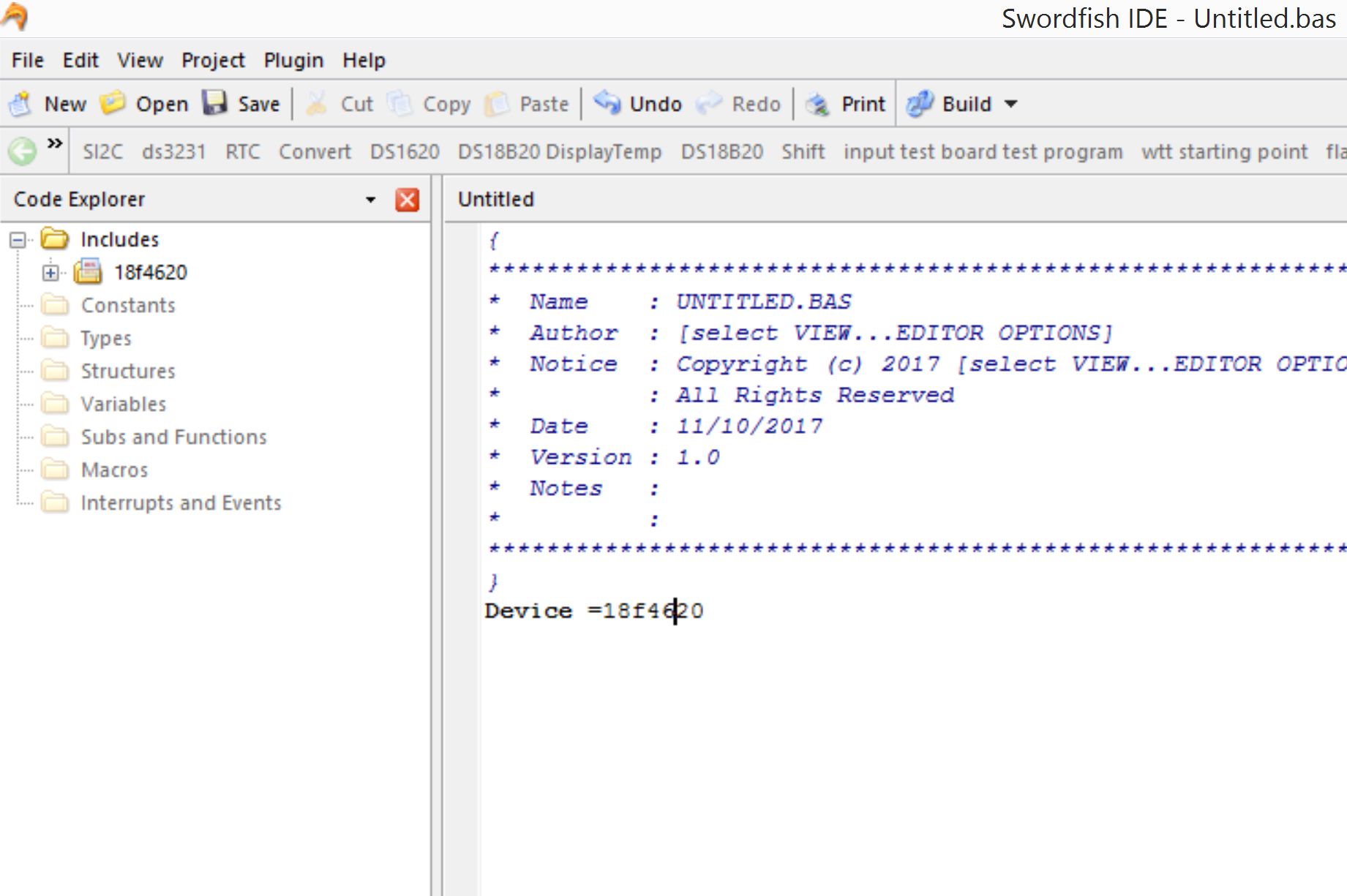

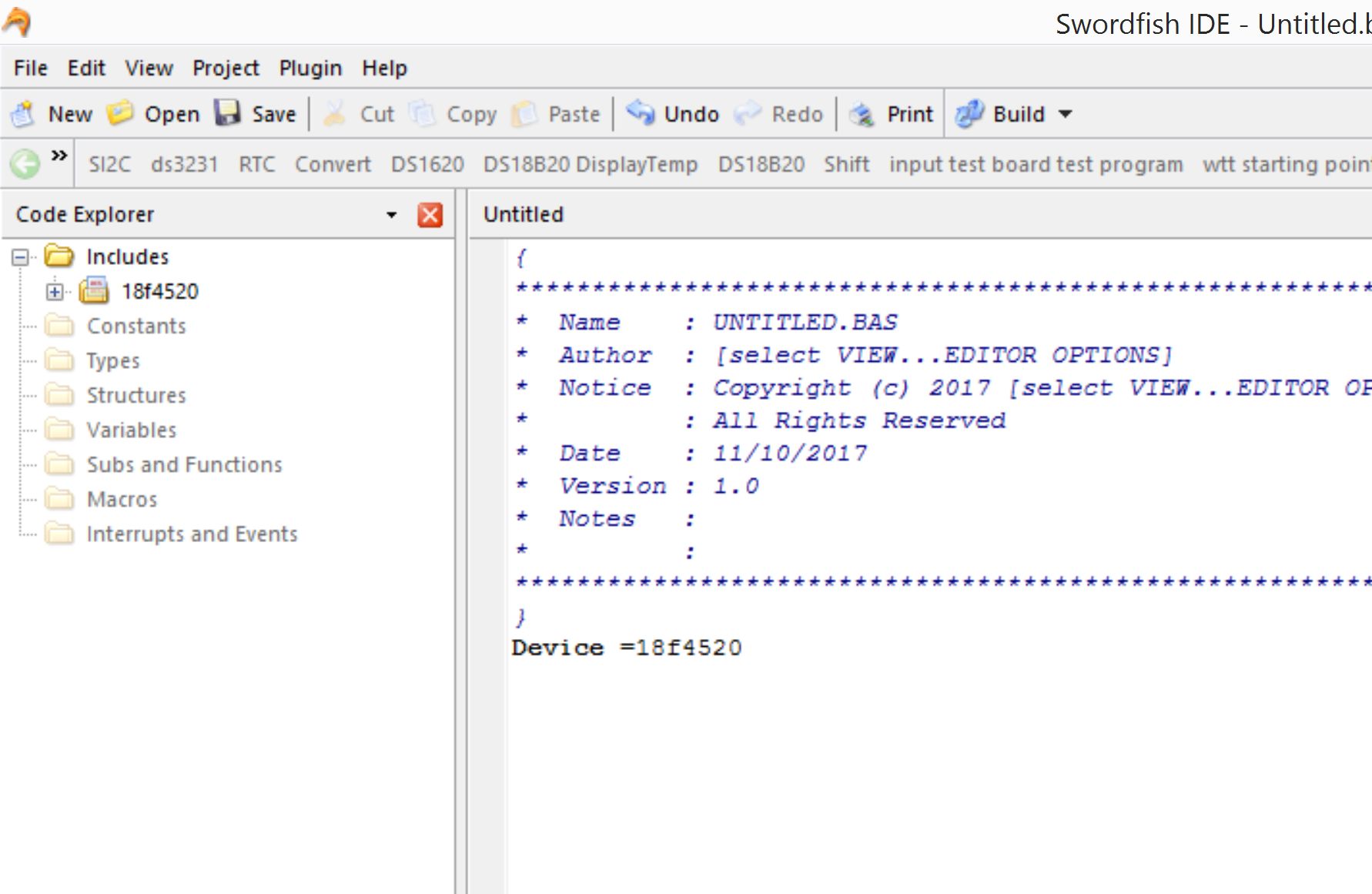

Darn it. I was going to check the 18F4620 and the 18F4520 in Swordfish, but I forgot. It's still early here.
Fortunately, both are included. BTW MrDEB - we have been over before that functionally, the LF version is the same as the F version; you don't put the L in the device specification in Swordfish.

I said in messages above that the F and and LF versions of a chip are functionally identical. These is absolutely no reason to think software will operate differently on the two.
I also showed above that the 18F4520 and 18F4620 are supported in Swordfish. And before you ask the question, I also explained that you do not need to specify (and indeed, cannot specify) the LF type as the device in Swordfish, because they are functionally exactly the same.
I will leave you to your studying and dissecting since they have served you so well in the past.
Swordfish supports every 18F (and LF) device except for the new K42 and K83 parts. That's close to 440 different chips.

As I mentioned before the supported list I printed out was / is outdated and the 18f4520 is not on that list.
Will download etc. tumbleweeds suggestion. As for LF I realize the only time one needs to specify the LF is when one order's said part. The big difference is the spec on the Vdd.
Started a basic schematic and going yto use Mikes suggestion and utilize a matrix on the 10 leds.
The 18F4520 should already be supported in the version you have... it's the default device if you don't specify one and has been for quite a while.
