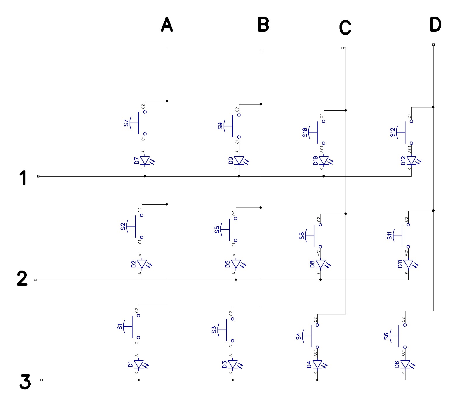

OK, assuming 20 LEDs and 15 switches/push buttons requires a 5x7 array, why do you need a 40 pin chip?
If I use a Matrix for the switches I run the chance of two button presses at the same time. I want to avoid this.
Yes this thread is getting long but different aspects of project design have been discussed.
The switches in a matrix is not off the table yet but the all LEDs in a matrix are on the table. Was searching for the keypad.bas module and all I could find was modified version that I need to test out.
Well after contemplating ideas and researching switch matrix I think I have a solution o prevent ghosting and lower the pin count. Just need a bigger matrix switch matrix.jpg
Those led's must be the latest They light with no ground. Oh you just want see when the key is pressed
that schematic is my bad but an idea. After posting and sitting in the car to go to church I realized my mistake.
The leds have no resistors and the inputs would be floating. Besides I need to have the LEDs separate from the switches because the LEDs come on when the input port goes LOW (pull-up resistors needed as well unless I enable the device pull-ups)and the LEDs stay on until the switch pulls the input LOW again. The bright side of this schematic got me thinking how to improve on the matrix idea. I just might be able to go back to a 28 pin device thanks to Pommies suggestion.

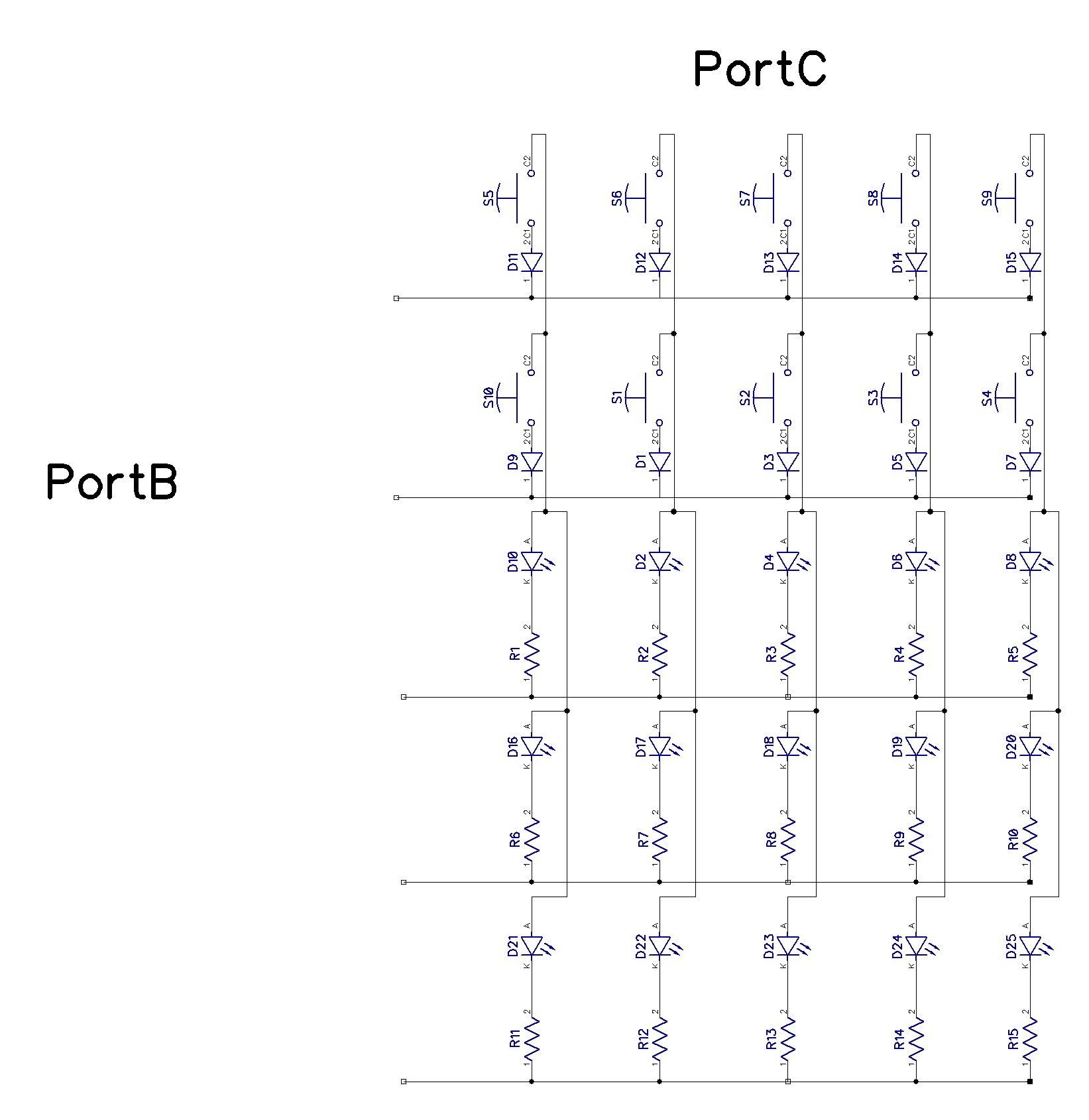

After several power outages due to trees I am able to get back to this project.
Was dealing with best layout to allow scanning the ports with limited issues.
The switches are mon. tactile switches and when a player depresses his/ her switch their led is enabled until a second button press.
I need to breadboard a portion of this matrix to see if scanning the ports will work. it should. and keep the desired LED enabled.
researching how to "dimension" or denote that player(1) switch is located at PortB.1 and led at Portc.2. Looking at the tetris games over at DDIY for ideas.
Can you explain how that matrix works? How do you read a switch?
I know people have suggested that you multiplex things, but realistically you would have a much better chance just using a single pin for each switch and led.
That's going to be enough of a stretch to get working. I can't image how many pages the scanning routine code we'd be subjected to would take.
If I recall correctly, we have discussed at great length that you can not assign an array of Player(1) to Player(n) to port pins B0 - B7. This can't be done in Swordfish. No matter how much you wish it to be true, it's not going to work.
With a 40 pin 18F-series chip, you have all of ports B, C and D available making 24 I/O pins available in a nice arrangement plus 8 additional port pins on port A and E. Even if you want to have 12 players, there's no need to resort to a matrix.
But so far, what you've described is best accomplished with toggle switches and LEDs - forget the micro. Player 1 flips his switch. The LED is on. He flips the switch the other way, the LED is off.
I know a flow chart is a mystery to you but perhaps you can explain from the moment you have 12 people cornered to play this game. Starting with what happens when they pull the device out of the box and find dead batteries, describe step by step what happens until the players shout hallelujah and scatter before another game can start. Explain step by excruciating step so that we can understand the great brilliance you are attempting to accomplish.
the only reason I wanted to try a matrix is a suggestion from Pommie. I realize I can't dimension a variable.

Let's look at the top leftmost switch S5 and diode D11.
What makes the PORTB pin it's connected to ever read a valid high or low?

He needs to turn on portc WPUs, (if they exist) then drive portb low 1 bit at a time in order to read the switches.

So sorry. For the chip we have been ealking about only Port B has weak internal pullups. Bummer.
what Pommie has posted, one bit at a time.
PortB wpu's are enabled and portC are cycled LOW (portC.bits(x)= 0) All portC ports are HIGH then scanned LOW.

When a player depresses his / her switch, his / her led comes ON
When player depresses his / her switch again the led is turned OFF
This routine has been written and works perfect. Now trying to include a matrix switch / led array as this was suggested to use.
I am using my Mexican Train basic idea and code and adding a second option of play where each player must complete his / her turn before the time runs out. If their time runs out, they lose their turn. Pretty simple if I use a 40+ pic which may be what I end up doing if I can't configure a method to use the matrix.
