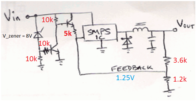

As your SMPS IC you're using will have a feedback pin, you can just inject a little current there to increase the feedback voltage and reduce the output voltage. The attached circuit shows a way of doing this.
The zener holds the left transistor on (and right transistor off) while the input voltage is at a sufficient level. When the input drops, the left trans. turns off, allowing the right to turn on, thus increasing the feedback voltage and reducing the output voltage (and allowing the input voltage to creep back up).

I've redrawn the circuit to show where a resistor and capacitor may be located to cause the response to have a gradual onset; this should stop the SMPS turning on and off sporadically, though it may cause it to oscillate somewhat... you'll have to experiment (or calculate the appropriate values and response) and you should be able to find a range of values that will be stable.

Can you post a quick sketch of the circuit & values you're using? There may be a simple fix to get the proportional control you're after.

I've attached your sketch (sans capacitor) with the values of the resistors I'm using. I played with the value of the 5k resistor a bit. At 10k, the output voltage would not go all the way down to zero during a low-input-voltage condition but finds a stable point at around 2V. This is probably as good as zero for me, given that the load is a 3.7V lithium battery, but I didn't want to risk this so I stuck to 5k - which does take it almost all the way down to 0V. I also tried a much lower resistance of 1k, but this increased the amplitude of the "switch-on-switch-off" fluctuations on the feedback pin to an alarming degree (purely a non-technical subjective opinion there!) so I concluded 5k would do better. Actually the amplitude of the fluctuations on the feedback pin don't appear to affect the fluctuations on the output voltage much - presumably something to do with there being a trade-off between switch-on-switch-off frequency, and amplitude - but I didn't look into this any deeper then that.

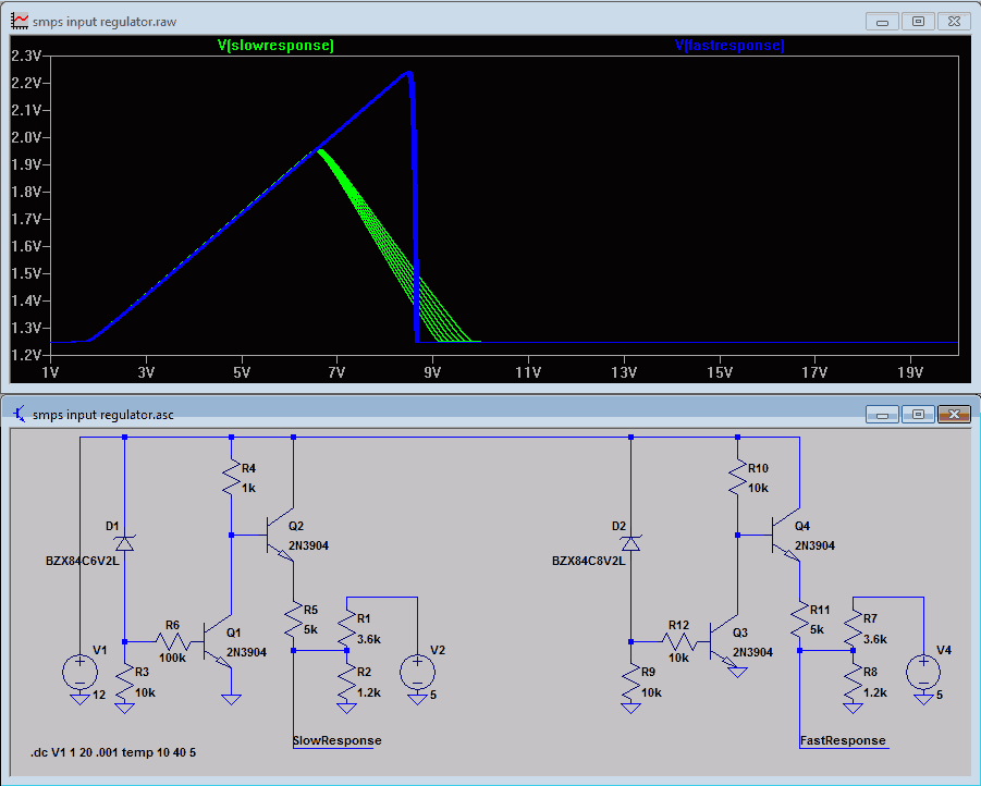

Finally, a quick note on this controllers functionality, though I imagine all these things work pretty similarly: The controller tries to keep the voltage on the feedback pin to 1.25V. So the potential divider I'm using here keeps the output voltage to 5V, because 1.25*(1+3.6/1.2) = 5.
If you change the resistor values, you should be able to slow the transition from ON to OFF. From the left, try changing the second and third resistors to 100k and 1k respectively. This will increase the voltage that the circuit comes into effect, so you may need to play with the zener value (perhaps 6V2 or 5V6) to get the voltage back down.
A simulation is shown, but without the SMPS - it should give a basic guide to how the circuit is operating. The multiple traces in each colour are because the simulation was run for temperatures between 10-40 degrees Celsius (lower temperatures = higher voltages). Note that the left circuit "SlowResponse" has a 6V2 zener fitted.
You'll notice that the range of cutoff voltage has increased with the slow response - this is because it is more dependant on the current gain of the transistors (whereas the original circuit was basically just ON or OFF).

I've just replaced the resistors as suggested and did a high->low sweep on the voltage of the input power with a benchtop supply. As you predicted it appears to have created a far more "gradual" impact on the output voltage which should bode well as soon as I can test this with a solar panel (still waiting for that sun!).
I'm going to get a bunch of zener diodes to see which zener voltage works best. As you predicted, the output power does indeed start to get "throttled" at a much higher input voltage than in the "on-off" circuit we were trying earlier. My only concern is that, with a low zener voltage of around 5V, the minimum panel voltage set by the system might then be too low for the circuit to carry out its primary goal - to avoid the panel getting stuck in a low-voltage stable point. But I'm feeling optimistic that this won't be an issue and I'll be back in touch as soon as I've got those new zeners and the sun finally comes out!
