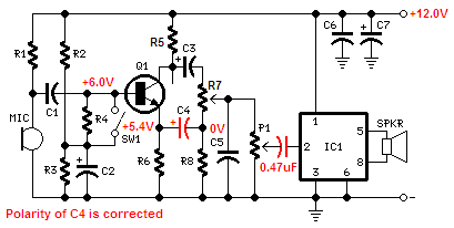

You wrongly connected the emitters of the transistors together! Why?
Look at the original circuit from RED Circuits where the collectors are connected together and the grounds are connected together.
Maybe you don't know which pin is the collector or emitter on a schematic so I labelled them here.
The sound from the master's mic is fed through its transistor to the amplifier in the slave where it is attenuated a little with R10 and R11 then amplified so it will be fairly loud.
(The original circuit used the TDA7052 (39dB gain) which has more gain than the TDA7052A (35.5dB gain). Also the TDA7052 has an input impedance of 100k but is only 20k for the TDA7052A so the attenuation by R10 and R11 in Boncuk's circuit is more than with the TDA7052.)
The sound from the slave's mic is fed through its transistor to the amplifier in the master where it is attenuated a little the amplified so it will be fairly loud.
You are supposed to adjust trimpot R7 so that no sound from the Master's mic comes out of its speaker and you are supposed to adjust trimpot R7A so that no sound from the slave's mic comes out of its speaker.

Since your circuit is silent all the time then you have something connected wrong. The difference between the TDA7052 and TDA7052A will be small. You did not say if you connected their grounds together.
Your DC voltages before were completely wrong but are good now. What changed?
my DC voltage were completely wrong, what's my mistake ? now, i just using 1 DC generator to connecting both +12v DC and Gnd togather....
and i added 0.47uF capacitor as you listed before, after that the circuit didn't shorted after i connected speaker, and also can transfer voice now....

It looks like the input coupling capacitor that is shown on the datasheet of the TDA7052A is important but is not needed for the original TDA7052.

Then why did Non89 say that the output voltages of the TDA7052A were corrected when he installed the recommended input coupling capacitor?
I think when the DC volume control was added on the TDA7052A then its input bias voltage became higher than 0V requiring the input coupling capacitor shown on its datasheet.

Look at the voltages on C4. The emitter of the transistor is at a positive voltage of about +5.4V and R8 causes the other end of C4 to be 0V. The original circuit had its polarity backwards. If you had yours connected backwards then maybe it was destroyed so replace it and connect its polarity correctly.

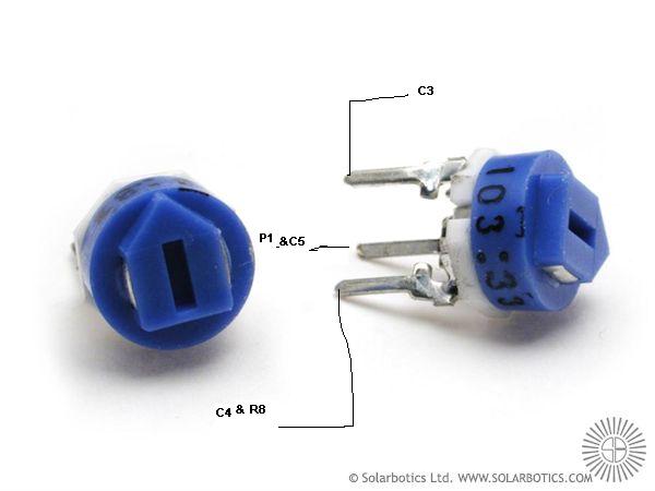

Then you have the transistor or R7 connected wrong. The collector signal is 180 degrees from the emitter signal. When you adjust R7 then the two signals cancel and there will be no sound from the local speaker. That is how the circuit avoids acoustical feedback howling.

just connected as shown.... the R7 just need to adjust once or everytime when speaking??
You should only need to adjust it once to get it to the proper setting.
