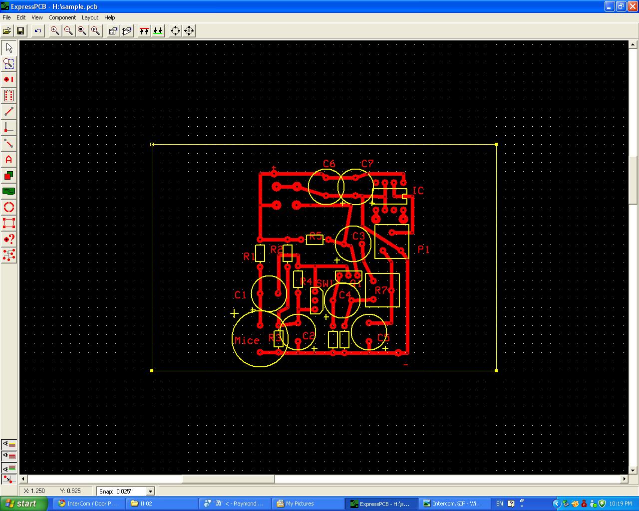

This is a typical example of "How not to design a PCB".
You're using the wrong layer for the traces. Using the bottom layer (16) for traces and the tPlace layer (21) for components you'll obtain a "look through the board" image. Using the top layer for traces you'll have to solder components from the component side, which is impossible since the solder pads will be obstructed by the part itself.
Using a double sided board with plated through holes the board is easier to populate and solder.
Further there are lots of acute and odd angles in the traces which will most likely lead to unsatisfactory etching results.
Last not least there are components overlapping each other from their size. How are you going to place those properly?

i will turn the tracing paper...
its because your PCBs provided seem cant been edit , some trace are wide , some trace are small ... and my college printer seem cant support to print it... that why i redesign it ....
there wont be overlapping on component, because i was using more larger component's size to design , this is why my design is bigger than yours ....

Take care to build the circuit mirrored.
The images provided here were *.gif files. You can't use them to create a board for two reasons: they are not to scale and they have the components. A PCB layout should be printed having the dimension layer (20) the bottom layer (16) and the pads layer (17)

Just check part sizes thoroughly. It's looks ugly anyway.
