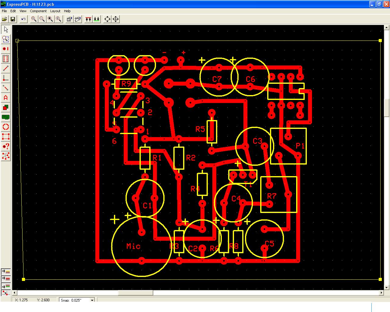

here is my PCB design , and the DTDP switch connection correct or not ?
once i trying the circuit , the circuit not function and the temperature of TDA7052 in master circuit continue increasing .....
This is a typical example of "How not to design a PCB".
You're using the wrong layer for the traces. Using the bottom layer (16) for traces and the tPlace layer (21) for components you'll obtain a "look through the board" image. Using the top layer for traces you'll have to solder components from the component side, which is impossible since the solder pads will be obstructed by the part itself.
Using a double sided board with plated through holes the board is easier to populate and solder.
Further there are lots of acute and odd angles in the traces which will most likely lead to unsatisfactory etching results.
Last not least there are components overlapping each other from their size. How are you going to place those properly?
Why didn't you refer to my PCB design? I guess the PCBs are also smaller than yours.
