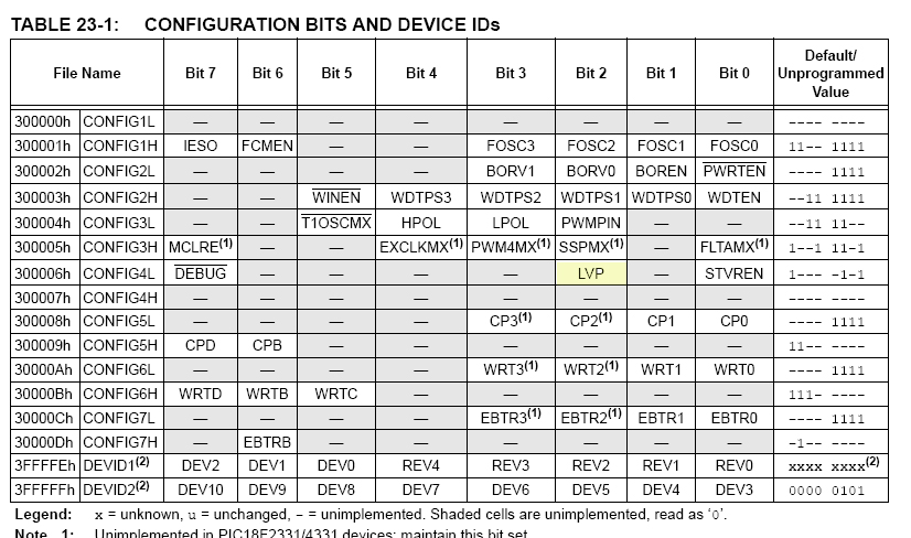

ED ...Just thought , LVP needs to be set in config bits also .?
ICSP, Ok,
I don't see LVP in config bits: attachment.

Just trying to cover all bases , its further down your config table.... You should be referring to the PIC datasheet more .
LVP is enabled by default . You probably need to search for a .bas clear / init routine.

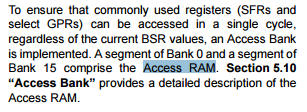

I wish I could be more help with the 18F2431 chip. Unfortunately, my experience is mostly limited to the mid-range and enhanced mid-range chips (e.g., 12F6xx and 16Fxxx or 16F1xxx chips). Whatever I say about the 18F chips is based on a brief comparison to the 16F series. My comment was generic, and as a note of interest, I was pointed in the right direction by the same Microchip forum that atferrari referenced.
You need to refer to the section in the datasheet that describes the memory organization. The Special Function Registers (SFR's) are described beginning around p. 65 through p. 69. I am sure you have used them, but may not have known them by that name.
The registers that specifically caused me problems are, using 16F nomenclature, the "Common Ram" and "General Purpose Ram." On the 18F, it appears Common Ram is still present (Bank0, 060h-05Fh; Bank1, 100h -1FFh; and Bank2, 200h - 2ffh). Note, those are 12-bit numbers and the first bit identifies the memory bank. The 18F has what is called "Access Ram" (000h-05Fh), which is 96 bytes. From my brief read, it appears those ram locations can be accessed from any bank in a single cycle and so might be considered analogous to the 16F "Common Ram" that can be accessed in a single cycle from any bank as well.
I was all set to post my Assembly program for clearing those registers, but after seeing atferrari's post, his code is probably more applicable to your situation. Our approaches were similar. I simply set up indirect accessing, cleared one register, incremented the file select register (FSRx), cleared the next register, and so forth.
In my case, the problem was created by using a Common Ram register for various flags. Those flags were not reset on re- programming and thus made the chip run erratically. For example, if an interrupt sets a flag for something and that flag is not cleared, your interrupt routine may see that "left-over" flag and not behave as you want it to behave. Of course, on the chips I am familiar with, clearing those RAM locations doesn't take long.
atferrari's routines also address the SFR's. He added a note of caution about erasing an SFR.

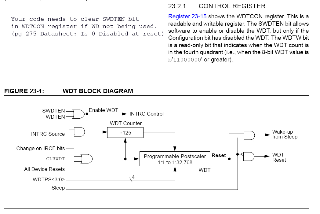

Hola again camerart
Do you have a way to narrow down the problem to see what register (or registers) is related to your problem? Otherwise you risk to spend lot of time chasing unexisting ghosts.
I presume that you could progressively "comment out" lines (or routines) until your difficulty eventually disappears. In fact, when creating software, doing the opposite, that is, adding progressively sections of code after the rest has been checked and accepted as OK, is the way to go.
If I mentioned the silicon errata, programming in no matter what language will not save you from the necessity to read it to see if your problem is coming from a flaw in the silicon. As you could check, depending of what batch each of your micros belong to, they could be differently affected (or not at all). Good thing to discard that and move on.
BTW, currently revisiting a project based on the eldest brother of yours, the 18F4431.
Buena suerte.

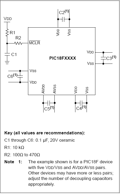

What do you have your MCLR connected to while trying to run the program? If you leave it floating it will probably cause issues. It's usually best to have it connected through a diode and a resistor to V+ (holding it high to prevent undesired resets). Also put a 100nF capacitor between the MCLR pin and ground. Actually, it'd probably be better to do this:
Connect a 100-ohm resistor directly to the MCLR pin.
Connect a 100nF capacitor between the other side of the 100-ohm resistor and ground.
Connect a 10K resistor between the side of the 100-ohm resistor opposite the MCLR pin and V+.
Some people use a 1N4148 diode in series with the 10K resistor "pointing" down from V+ to the 10K resistor. This will prevent any oscillations from the power supply, but probably isn't necessary.
I still haven't seen a schematic for your current setup, so I don't know if you've done this already or not.

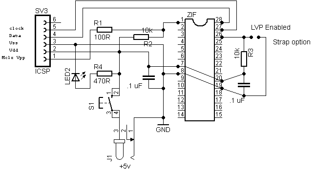

Hi camerart. OK . the zif is a good idea , as stray connections need to be considered if doing ICSP . however you still need power caps and a pull-up during programming , ( I don't see them on your pic) also I would use external power during programming , as not all USB power is the same as your .5v ac measurement shows. (Is this a laptop USB port ?). WDT may be a wild goose , but worth checking .
Judging from your other project posts you seem pretty capable , I would suggest a course of action... put the zif on a stripboard with all the connections as detailed . add an external 5V supply plus a switch and led indicator .
Think john's post was referring to a routine to clear or initialize registers / data memory at start up (most important ).
Edit. I added a quick circuit of my ICSP setup as used with PK2 and PK3 with my PIC 16 /18 /24 dev bds . above specifically for the 18F2431
View attachment 91502View attachment 91503

Check your work with dmm without a pic in ZIF (even the best EE's make mistakes) , The circuit on #36 was specifically for picf2431, I had a look at 18F4520 below , I'm thinking you could add straps to cope with pinouts. not an ideal solution as it introduces opportunity for mistakes ,( I'm leaving you to sus it out ) keep in mind all the pic Vdd /Vss pins need a supply and a bypass 0.1 uF . and its not a good idea to supply I/O pins directly with Vdd .
Q are you understanding the various posts here regarding LVP ?
( Mistake ! Pin 1 is OK should have had green ink )
