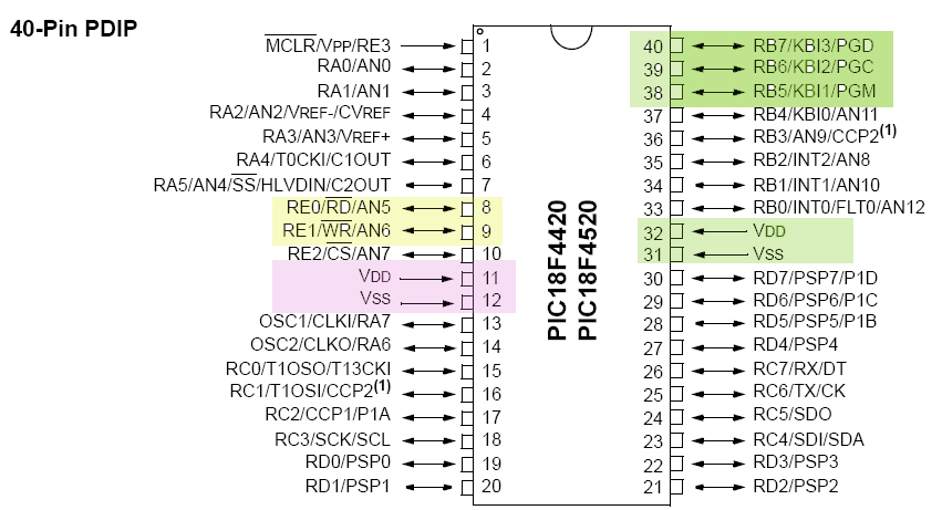

Check your work with dmm without a pic in ZIF (even the best EE's make mistakes) , The circuit on #36 was specifically for picf2431, I had a look at 18F4520 below , I'm thinking you could add straps to cope with pinouts. not an ideal solution as it introduces opportunity for mistakes ,( I'm leaving you to sus it out ) keep in mind all the pic Vdd /Vss pins need a supply and a bypass 0.1 uF . and its not a good idea to supply I/O pins directly with Vdd .
Q are you understanding the various posts here regarding LVP ?
( Mistake ! Pin 1 is OK should have had green ink )
As both PICs (18F 2431 and 4520) have the same connections for MCLR,PGD,PGC and PGM and the only other differences are the +v an 0V pins, I will try this wiring: See attached.
I think my Zif was wired as my orange wires (18F4520), and when the 18F2431 socket was used, the black wires 7,8 are also connected. This appears to be ok.
I've just looked at the PDF LVP, and almost get it. With a jumper on the Zif circuit, will that be ok?

The circuit in Post #36 will only work if you are powering your target circuit from the PICkit.
Your zif circuit supplies Vdd to pin 7 18F2431 = OK for 18F4520 not recommended ! (Although you really have to miss treat a PIC for it to fail ) , if you want a dual zif socket suggest below.
The LVP disabled , jumper on, and config LVP bit=0 , should be OK , the port RB5 (pin 26) will function as I/O.
( This drawing is getting a bit messy as did quick mod )
