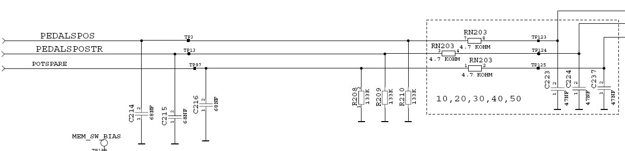

Well you need an ESD cap too. The resultant voltage at the pin is reduced via charge sharing between the ESD gun / person and 68nF capacitor.
Overall circuit is like the attached schematic (3 separate analog inputs shown).

I'll have to toy around with that, I've never found any decent static discharge models for simulating. Then again I've never looked, and never put something in an environment where it might be an issue.
