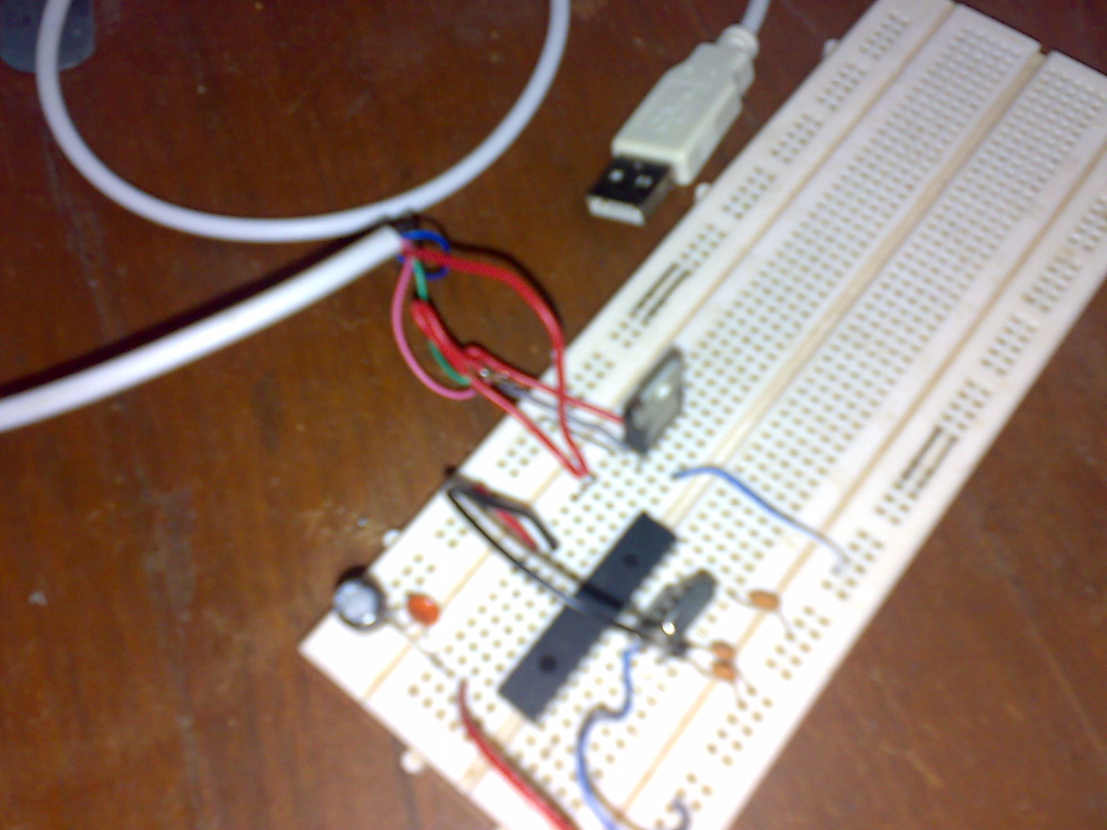

Thanks for your reply Sarma.I used a 7805 for the communication part as suggested by Bill above but got nothing.It says an unkwon USB device detected.The multi meter is ok cause i checked it in another PC but got 6.8v on the USB there also.When i connected the 7805 i got a nice 4.8v.

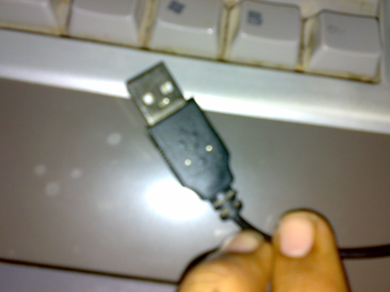

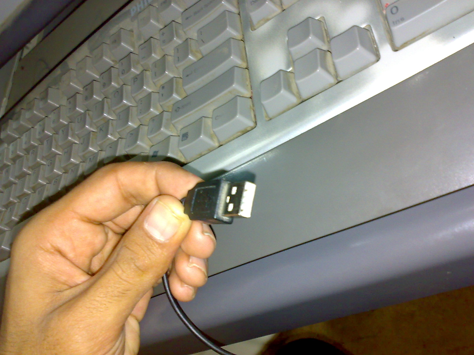

Thats exactly what i am thinking cause i dont know how do you connect the port since i am using a cable rather than a mount on version.Thats why i asked Bill two times about my USB connections but i guess it is very hard to understand al the Left to Right stuff since one cant see it.I am uploading some pictures.This is how i have connected hte USB. The 3 arrow side up which brings the white plastic part to the bottom.The port is mounted on the top right, that way starting from the bottom(taken as ground) i go up. Is this way correct?
If i put a female port in its place and make a male male custom cross over cable will that work?Since mount on female ports are very common.
7805? where?
do you mean buffered USB power supply instead of using the original power?
why not put up a little schematic of what you actually did?

Do not confuse USB with RS232. RS232 has a send TX and a receive RX line. USB does not work this way. The DATA+ and DATA- lines are used as a differential pair to both send and receive data.
If you make a RS232 like crossover cable you will end up with DATA+ hooked to DATA- etc. That will not work.
DATA+ need to be connected to DATA+ and DATA- to DATA-.
RS232 uses 3 wires, TX,RX and GND. To send TX and GND are used. Receive uses RX and GND.
The problem with that is that interferance can degrade the signal. To get around that USB uses a differantial signal. Instead of a GND it uses a DATA-. The DATA- signal is made negative when the DATA+ is positive. This sort of signal is much less prone to noise. That means greater speed.
Also the same differential pair is used by everyone to send and receive.
So inorder to make sure that i dont get the USB connector worng i just make a simple male male cable and connect it to the female port on the programmer?

Hi Sarma this is how i connected the 18F2550 using the communication config with the 7805.I left the DATA pins as theya re and connected the +5v to the 7805 i/p.

3V0 i just checked my USB connections with the ones you listed. I have connected the D- and 5V lines on each others place i will correct that and have my fingers crossed. Thanks.
