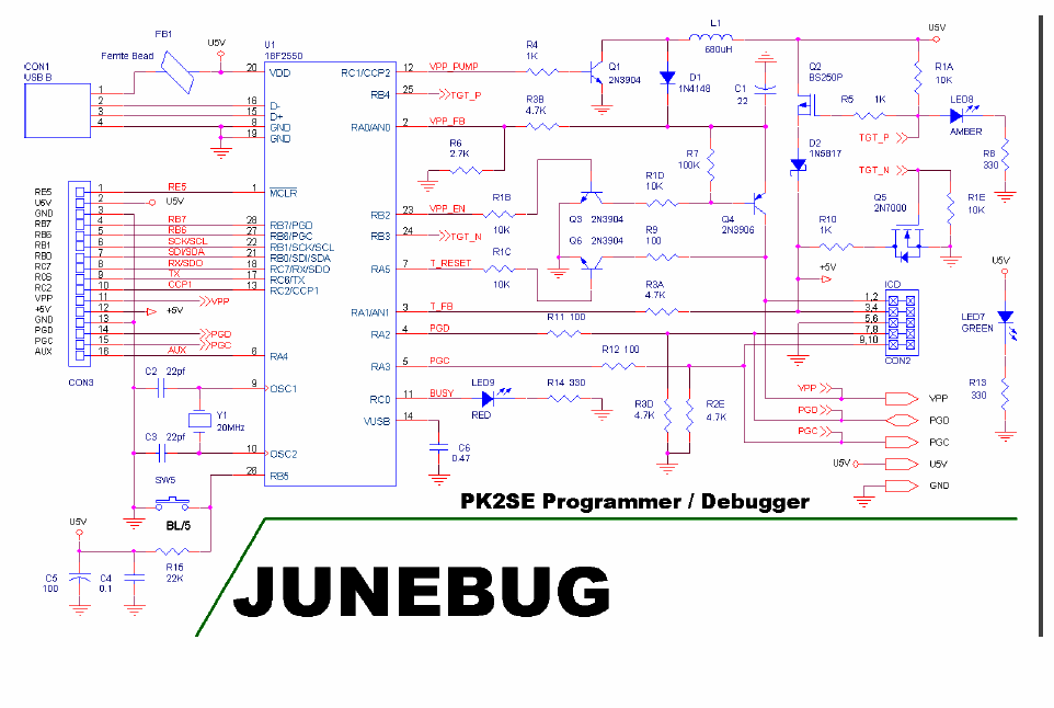

is it definitely above 500uH. if not this Vpp problem would arise. for low Vpp error, check Q6,7and 8 whether they are proper in type and mounting.
also the MosFets(Bill advised you that they are not that important and gave a suggestion how to avoid them for the time being.
many a time these Q6,7and 8 skip observation. the best would be to remove them all together. place fresh ones. . never replace a device because earlier so and so was there. a mistake done at the beginning, would be repeated. then, if you use other than 2n23904 and 3906 that follow EBC order, judge the pins order as per the device you use. For example BC547 and 557 follow CBE order as against 2n390x.
the electrolytic capacitors can better be tantalum caps instead of cheap ones that might be some times leaky.check whether the 4k7 and 2k7 chain after the diode D4 is proper and not reverse. of course i am also getting similar message of Vdd on a full version assembled and trying to debug it.

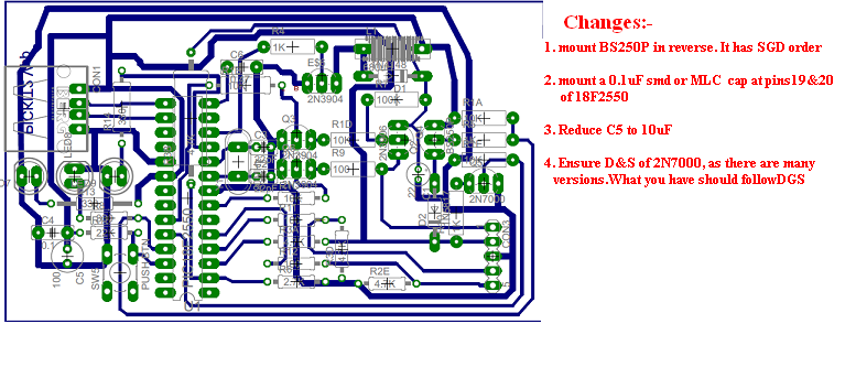

Hi again. Here goes nothing there is no point in keeping it when it doesnt work.Here is my PCB. I am also including the Junebug CKT daigram.
This error is for Vdd even when it says there are 5v. It says it is an external voltage. Gayan said that i needed to supply target externally which i did but the error was still there cause the Vdd pin was left open.
please study the attached png file and the remarks therein.

first of all there are some inconsistencies in the artwork and i really don't know whether you have considered the aspects indicated by me in the earlier post. there would be NO RESULT unless you approach systematically.
I did substitute C5 with a 10uf. The 2N7000 has its terminals correctly(checked using the diode). As for the BS250P it got damaged and now there is a short between its drain and source( I imported it and it is not available here normally). Is there any other MOSFET i can use?.Did the .1uf (ceramic) cap also. Since i am going to make the PCB again i want to know what inconsistencies have i done except the ones that you have already stated so i can correct them.I am making a new one to make every thing clear and systematic. Thanks.
