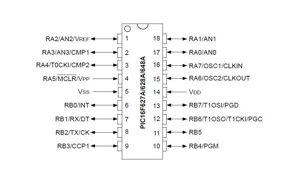

Now since i got it working it is not detecting the 16F628A i connected with it on a solderless breadboard.Heres how i made the connctions:
Vpp=4
Gnd=5
PGD=13
PGC=12

That looks right to me.
Use the PICkit2 trouble shooting tool to check signals and voltages. The tool explains itself.

I am using the ICD pins k.All other are confirm but pin number 3 of 18F2550 is T_FB. I have taken it as Vdd.
