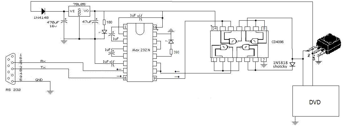

I'm not expert in eletronics circuits, but I need make a device to learn the IR signal from a DVD-Record (panasonic dvd dmr-ez28) and send to PC. Then, users interact with the software and it sends the signal directly to a DVD (not over IR Led, to not lost samples).
The IR Module is like this one:
tsop4838-ir-receiver-module-38khz-rc-jpg.51201
The output is HIGH if NOT detecting any infrared signal and goes LOW if infrared is detected..
Based on circuits over the internet, I made this circuit attached.
I have some troubles:
  • The LED on the MAX232 be always ON. When the signal is received from IR module, the LED blinks. The right is the LED stays off and flashes when receiving the signal.
  • Serial port don't stop receiving information, even when the IR module is not sending signal. It looks like some kind of interference.
  • The DVD player does not recognize the signals sent by the PC.
Please, could anyone help me on this circuit?
Many thanks!
Alessandro
Remote controls don't send RS232, or anything like it, so you can't use aserial port like that - and there are huge numbers of totally different systems in use.

Use a fast opto coupler from the printer port to the IR. You need to send an unmodulated code, see LANCs / SIRCs (Sony) for examples. Your Panasonic will have its own protocol but the method will be the same.
From the hardware standpoint:
If it is 5 volts comming frove the dvr then the 7805 regulator won't work. If it is 12 volts it will be to high for the ir sensor.
You right. This diagram is old... For my test, I used a external font connect into to regulator 7805. Just the ground is common between the font and the DVD/IR Module.

There is no problem to use parallel port. But, could you help me on this circuit to use the parallel port?
An IR receiver IC could connect directly to the parallel port, and a simple transistor buffer could feed the DVD IR input.
You would need to write a program to read the IR signals, and then output similar signals.
I did it years back on a 386 laptop under DOS.
