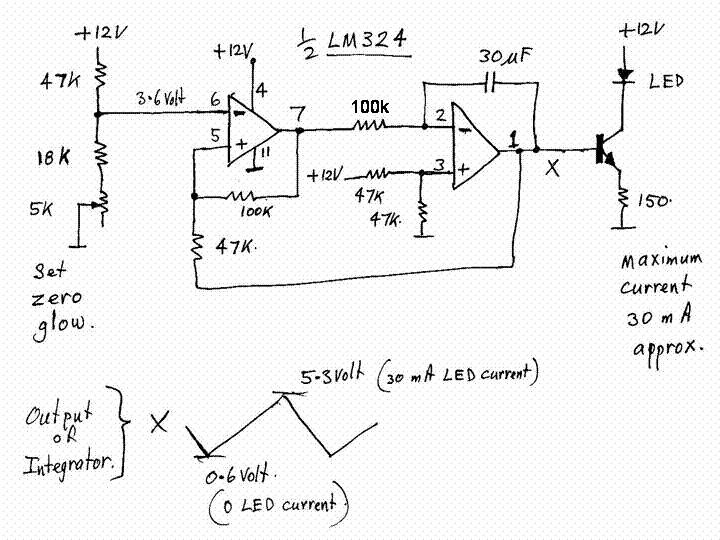

Here is a circuit that I designed for someone else some time ago.
It does not do exactly what you want but it could be adapted.

The circuit in post #15 will need adapting to get a 30 sec fade period. It currently gives a 3-4 sec period.
Re Ohm's law, take a look at the stated voltage at point X in the schematic and work things from there.
Is it possible to make it adjustable? not a huge deal if it requires a whole change.
also for post #15 mine is a LED strip so I don't know how much that has in common with the luxeon LED's
If you mean the post #11 circuit it is already adjustable, using the pot labelled 'Set time'.
