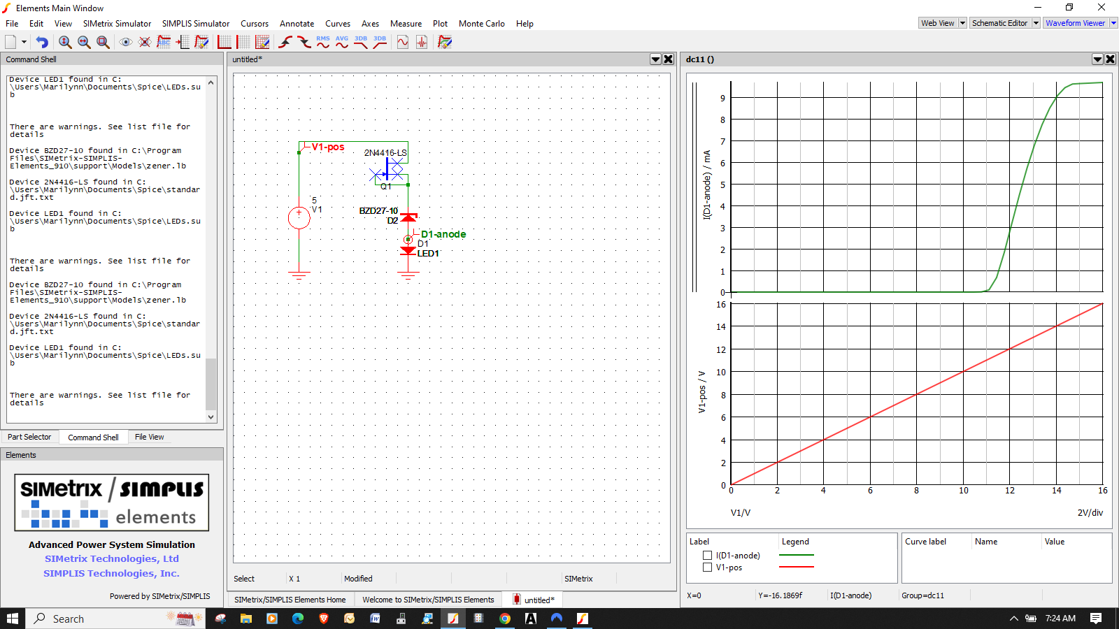

Something like this :
Replace the JFET with AL5809 from Diodes Inc, a constant current diode. I could
not get its model to work right in simulator. So used a generic JFET to show rough
sim. So when ramp hits Vzener + Vth JFET the constant current diode turns on.
So worst case the AL5089 and Vz choice/tolerance to get behaviour you want.
One issue with new LEDs is uA of current will make them glow, so pick Vz to have
low leakage.
Regards, Dana.

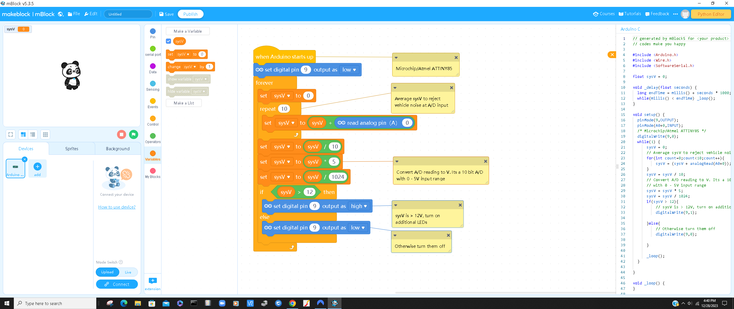

better solution is a comparator based one where the high G "switches" the LED on. Or
a small micro with A/D would do it :
What is your required LED current ?
A quick and dirty way doing it with 8 pin micro :
Note I could have easily added PWM control over brightness to minimize energy
needed as well. Lots of variations easy to add. The above is mBlock, easy to use
GUI block programmer. Just drag and drop blocks, set their values if needed, and
mBlock converts to C/C++ for you, right hand window. Then you use Arduino board
to program chip.
Something like this, diode to protect from load dump in vehicle :
Note I did not correct for V divider in code to compute 12V, leave that up to user.
So that correct V is computed in code. Just alter the sysV computed V by divide
factor. Also ATTINY85 needs 5V supply, a regulator rated for load dump or a R and
Zener would suffice.
Regards, Dana.
