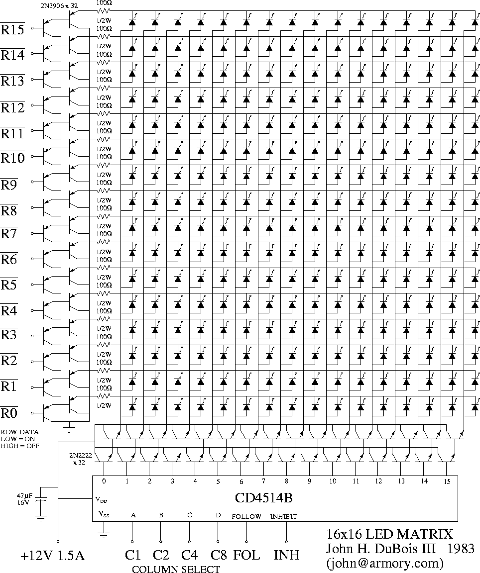

You're thinking off the wall but you don't understand the straight forward principles. You're talking about using constant current excitation for uniform brightness but the reason you didn't have uniform brightness is only because you screwed up the 2 component system of one resistor and one LED. If you can't get that right, a more complex (and totally unneeded) solution won't help.
