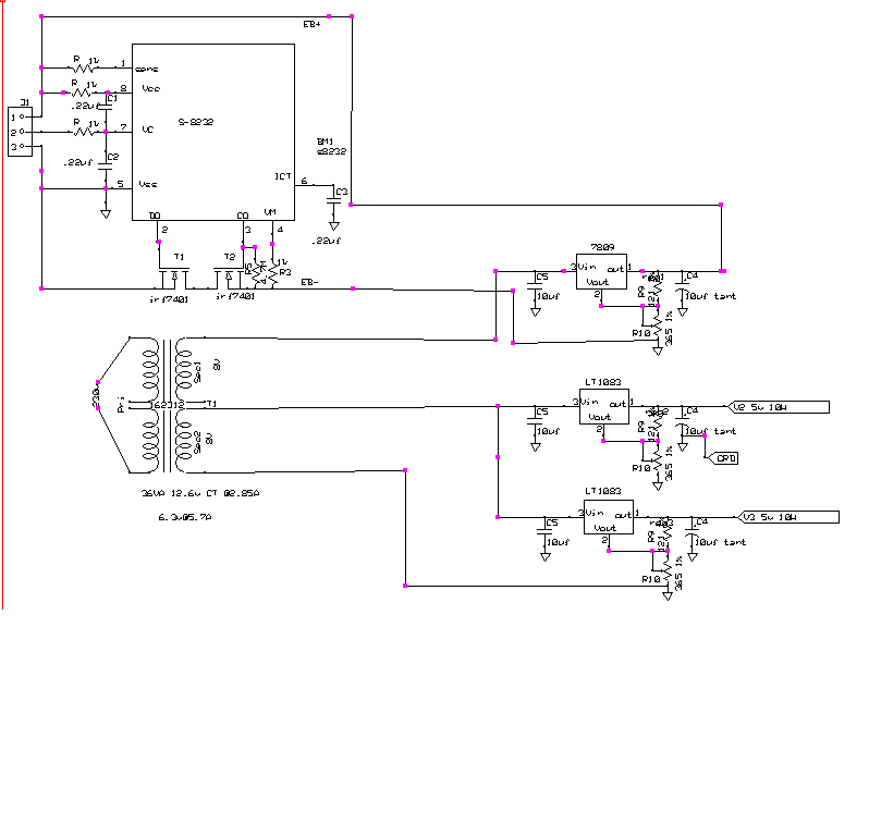

the regulators are LT1083/12 and LT1083/5. really need a 9 v for charger but 12 shoudl do it but input voltage is 12-14v. need to address this. perhaps a 7809 would be better? only need 1amp as the battery max charge should be maxed at .700 as per recommendations.
If you have 12V into a linear regulator that has an output of only 5V then you are heating the world with 7W if your output current is 1A.
7W is a lot of heat in a little voltage regulator.
How will you get rid of that much heat?

will look for a LDO for say 9v instead of 5 or decrease input voltage seeing hoe the input is 12 v vehicle or 220 ac
I contemplared and kinda looked for a reguilator for 9 volts (this is for the charger portion)
data sheet about voltage supply
In the S8232 diagram it shoiws what looks like a duel polarity supply?
has + - and GRD??confused

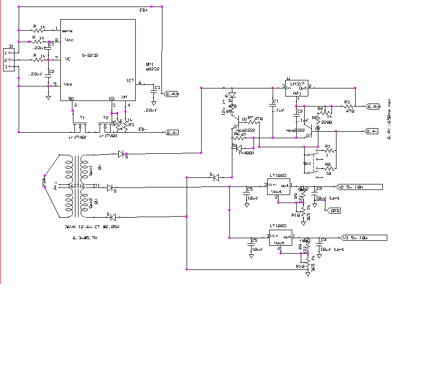

revised idea for powering this Li-PO charger. two input supplies 230v and vehicle (12-14)
need heat sinks for sure

once again: the S8232 is not a LIPO charger, but a LI-Ion charger IC.

The S8232 is not a battery charger. It is a battery protection IC. A battery charger has a current limiter and voltage regulator. The protection IC does not have them and simply shuts off if it detects a voltage or current that is too high.
The battery charger circuit with the LM317 might work. The transistor limits the current and the resistors make a good voltage regulator.
The circuit must have a timer to shut it off because trickle-charging a Lithium battery is not allowed.

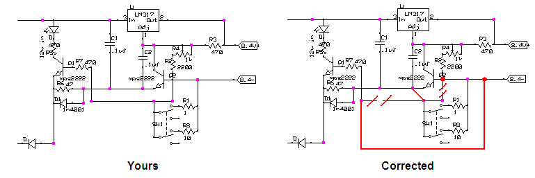

I corrected your schematic.
We is going to have to rename you, instead of audioguru how about OLD EAGLE EYE
thanks, I see my mistake

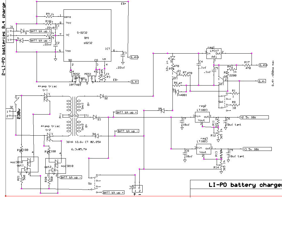

added car adapter and 220 inputs
This circuit is taking shape. Just hope its right.
Looks right but then several pair of eyes may find errors. Like OLD EAGLE EYES (audio guru)
want to isolate the batteries from the aux outputs (reg2 &reg3) but think that the secondary windings have current when vehicle connected (enabled by switch sw2.
the two triacs are probally not needed, one would do but the two will shut off ALL 230V inputs. SAFETY?

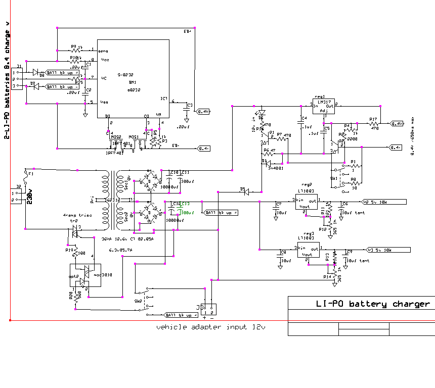

Your AC power supply uses half-wave rectifiers instead of full-wave rectifiers. It is missing big filter capacitors so the rectified voltages are jumping up and down.
One of those forgotton items. I usually use a fullwave bridge rectifier but why not here?? brain fart.
Filter caps - never even occured to me - thanks.
I took out one of the Triac, opticouplers. Takes up too much landscape on pcboard.
will add suggestions and repost.
revised power supply
removed one opti/triac, added fullwave rect. and added filter caps.
might be wrong on cap values?
