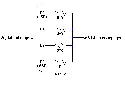

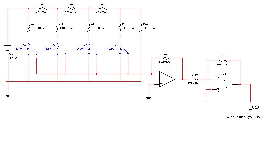

so now i am stuck to another problem. i require to control it from a digital circuit. as i see from the schematic i need to apply a voltage from 2.6 to 9.4 to the inverting input of U1b. i will have to generate this voltage from 4 digital outputs, wich will have 12V for H and 0V for L.
any1 knows how to do this.
I would recommend a 4-bit D/A converter with a parallel interface for the input switches. But I know you said your parts availability is limited, so you can actually build your own using a circuit called an R-2R ladder. Check out the circuit below. It's best to use 1% tolerance resistors if you have access to them. This circuit will give you an output of 0-11.25VDC, in increments of 0.75VDC for each binary number from 0-15. The switch on the far left (D) is the MSB, and the switch on the far right (A) is the LSB. Connect the output directly to the inverting input of U1B.

that's what i want. just that i want to take the output from a 4029 counter. it would be easy if i had a counter like 4017 but wich can count both up and down. know any IC wich can do this?

The DAC is a good idea, but I think an R-2R ladder is overkill for a low speed, low resolution (4 bit) application. Here's a simple DAC you can connect directly between your counter and your comparator in the PWM circuit. Make the resistor values large so that the output resistance of the counter is insignificant. I would make R at least 50k and pick the nearest 1% values. For example:
R=100k
2R=200k
4R=402K
8R=806k
Many other combinations will work.
Both of these DACs are designed to work with binary counters, so a counter like a 4017 wouldn't work, even if it did have up/down capability.
