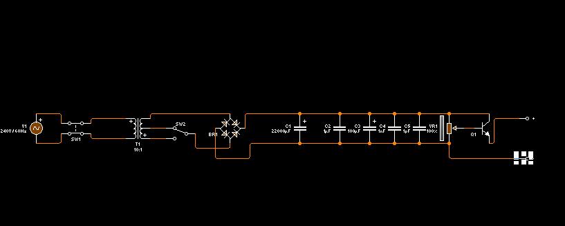

you can do this for about £40 buy a transformer that outputs 30v there sould be 3 wires on one sid and 2 on the other. this means you have 1 coil on the mains side and 2 coils on the output side if you put the ouput coils in parralell you put 240vac in the mains. if in series you put 110vac i would say use 5 caps 22000uf, 100uf, 1uf, 1pf and 1nf put them all in parralel from the output of the transformer. use a tip32c transister to vary the voltage. here is a curcuits diagram i through together.
That's pretty horrible as well :lol:
And why all the capacitors in parallel?, all you need is one reasonably sized one.
The idea of using a transistor to stabilise and vary the output voltage is the correct one, but NOT just fed from a potentiometer!. It needs to be part of a proper stabilised PSU, of which there are a great many varients.

the caps just get smaller, as long as they get smaller it should work. not transistor, transformer. i have built this circuit and it works ok for me. it does vary from 30v to 0 and has no short circuit protection. the bigger the transistor and transformer the more wattage you will get. i used a power transistor but a medium transistor will do for what you want, i wanted 20amps at 30v. hope that helps.

danielsmusic said:
ant9985 said:
thnx daniel.. but how do u did u come to those capacitor values and do i choose a transistor rated at 39VA just with 3 input wires and 2 output? i cant just put in a circuit without them knowing how i came to it. but thnx for the help.... why do you want to know my age? im 20
just curious. i was thinking gcse level.
You have no regulation with this circuit. All it provides is a way to vary the output voltage.
The pot feeding a power emitter follower isn't a variable voltage regulator. It is a current limiter with a set max voltage without a load. As the load current increases, the transistor's base current also increases which causes the pot's slider voltage to drop and the output voltage too.
yes you are right but this was the quikest thing i could think of at that time. :oops:
