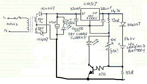

Hello again,
Hey no problem, just rewire your transistor and you're all set right?
Here's a drawing showing the transistor emitter a little clearer.
Oh but i am not sure if you want that diode in series with the battery for an Li-ion as that messes up the voltage regulation a little. It's up to you though.

Hi again Spec,
As long as 33R is connected I get no output and the red led does not turn on (ever). If I pull 33R then I can adjust the output current (it won't go down low enough without a change. Not able to go below 80ma and my battery only need 12ma. ) and the red led is on when not charging.

Hi BM,
As Ron Simpson and MrAl point out, there is a gross error with the circuit of post #8 in the area of the transistor.
I will post a corrected circuit, which I hope will be OK.
Apologies for the inconvenience.
spec
... I am not sure if you want that diode in series with the battery for an Li-ion as that messes up the voltage regulation a little.
Hi MrAl,
You are correct about the undesirability of the diode in series with the output but, on balance, it should be OK for a lead acid battery, which is the target application.
But even so, the voltage effect of the diode is not that great.
spec

Hi again BM,
Below is the corrected circuit for the LM723 battery charger.
spec
NOTES
(1) LED 1 needs to be a very high efficiency type (714uA)
(2) To set the charger up for a 12V, nominal, lead-acid battery, set RV2 (CURRENT) to maximum resistance. Connect a 1K resistor across the charger output terminals (no battery connected) and adjust RV1 (VOLTAGE) for an output voltage of 14.1V
(3) For an output voltage of 14.1V, RV1 (VOLTAGE) will be set to around 1.34K
(4) There will be a standing current of 10.42 mA flowing through the current sense resistors (RV2 + R4) by virtue of the 120 Ohm resistor connected between the LM317 OUTPUT and ADJUST terminals (1.25V). This standing current through the current sense resistors (RV2 + R4) will drop by around 714uA when current limiting is active.

Hi all,
I have been trying to get this battery charger working. I found the schematic on the web and it all looks good (to me) and others claim it works, but for me I can't get the LEDs to work right. The green is supposed to be on while charging and then when the battery is charged (the Zener in reverse bias) redirects the current to the npn transistor through the red led on the way to ground. This is supposed to turn off the green and turn on the red. For me the red comes on when it's charging and the green is always on. Any ideas?
The output current of the original design does not seem to be high enough. Is that really what you need or was there an error?
