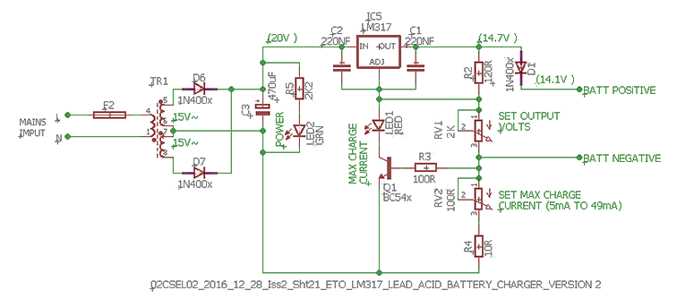

Hi again BM,
Below is the corrected circuit for the LM723 battery charger.
spec
NOTES
(1) LED 1 needs to be a very high efficiency type (714uA)
(2) To set the charger up for a 12V, nominal, lead-acid battery, set RV2 (CURRENT) to maximum resistance. Connect a 1K resistor across the charger output terminals (no battery connected) and adjust RV1 (VOLTAGE) for an output voltage of 14.1V
(3) For an output voltage of 14.1V, RV1 (VOLTAGE) will be set to around 1.34K
(4) There will be a standing current of 10.42 mA flowing through the current sense resistors (RV2 + R4) by virtue of the 120 Ohm resistor connected between the LM317 OUTPUT and ADJUST terminals (1.25V). This standing current through the current sense resistors (RV2 + R4) will drop by around 714uA when current limiting is active.
(5) Decoupling capacitors, C1 and C2, should be disc, +-10% disc ceramic types with an X7R dielectric.
(6) C3 should be a high ripple current, low ESR capacitor intended for reservoir applications. The dielectric can be aluminum or polymer.

Well I tried to sort this out on my own but it's not working out. I wanted to use this on a small 1.2Ah 6v lead acid battery so I made some adjustments. The charge voltage and current adjust down to my needs just fine, but I'm unable to get the red led to come on except for a very slight glow. I've tried adjusting the bias resistor but it isn't making enough of a difference, I also tried splitting R2 into an 82R and a 39R and placing the anode of LED1 between (effectively keeping the total for R2 what it was). Help! Please!
Hi BM,
Am I right in saying that the circuit of post #49 is charging your battery OK, but only at a low current and that the only problem is that the LED is glowing dimly.
Assuming that the above is a correct interpretation.
(1) In its present configuration the circuit will only provide around a maximum of 49mA of charging current. The circuit has not been changed to supply 120mA which was a later requirement. I will have a look at increasing the charging current to 120mA.
(2) There will only be about 700 mico amps flowing through the LED so if you are using a standard LED it will be very dull. As I said you need a high efficiency LED. Have you in fact fitted a high efficiency LED?

No, sorry, I missed the high efficiency led.
Is it possible to have this work with a standard efficiency led.
I have no problem getting 7.2v or more and a couple hundred ma out of the circuit with the the design as it is.
I did try configuring the circuit for a normal efficiency LED but it got a bit awkward
Hmm that is odd because the maximum current, with the current control potentiometer adjusted to minimum resistance should be around 49mA.
A lead acid battery charging voltage should be 14.1V, but you mention 7.2V. Are you in fact charging a double cell lithium Ion battery, from a camera for example?

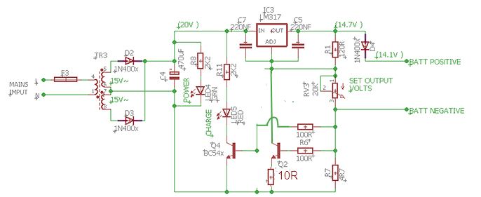

Hi BM,
Below is a revised battery charger schematic which provides 120mA charge current and uses a normal LED (afraid I had to add two transistors).
spec
Spec,
Submitted for your review.
The new 10R resistor is added to get Q2 to turn on slightly after Q4. (about 0.1V across 10R)
Purpose: to pull "ADJ" down as low as possible under high current conditions. Even now it does not handle a short well.

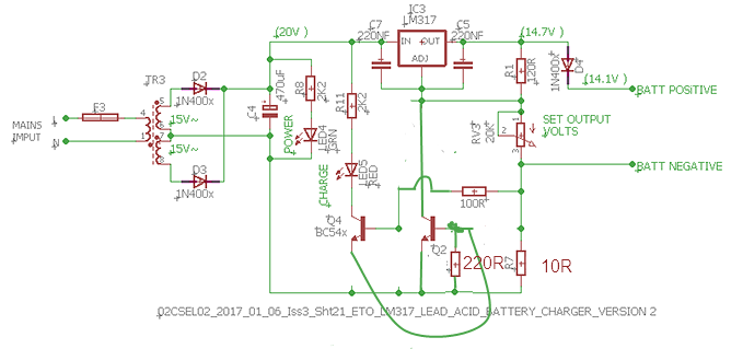

Spec,
Nice Ron- one transistor less.
Did you mean just 10R in the emitter of Q2. That only gives 714uA * 10R = 7.14 mV
What is the problem with the short circuit condition?
spec
Spec,
To the question of 10R: I was shorting to ground the current in 120R. (right/wrong?) I thought 1.25V on 120 ohm.
The idea that Q2 does not function under a short condition is heavy on my mind.
Here I jacked up Q4/Q2 so it takes two diodes drops (1.2V) to get current limit. Something I would not like to do but....
So with 1.2V across 10R then Q4 should turn on and light LED5. Then the LED current appears on 220R and pulls back IC3.
What I was trying to do is to pull "ADJ" to -1.1 volts under a short.
Comments. Thanks.

Spec,
Comments. Thanks.
You probably won't believe this, but I was thinking along similar lines.:)
I also considered putting an LM358 in to turn the charge LED on, but didn't think that an opamp would be in the spirit of the circuit.
I still cant find an issue with a short across the output terminals of the charger of post #76.
As I see it, under short circuit conditions Q2 will be conducting, the voltage drop across the 1N400x diode will be 0.6V and the voltage across the 4.7R current sensing resistor will thus be, (0.6V [Q3VBE]+ 0.1V[Q2VCEsat])+ 1.25 [LM317 Vref])- 0.6V [1N400x Vf] = 1.35V. This means that the maximum current will be 1.35V/4R7 = 0.28A
Where have I gone wrong?
Of course, with the original circuit, which had the red LED (1.2Vf) in the collector of Q2, the short circuit current would be higher by about 0.6V/10R = 0.06A, giving a total current of 0.34A
