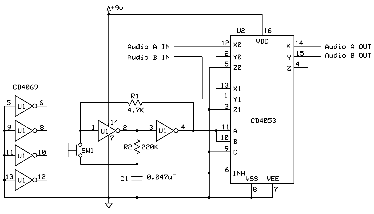

Can your audio signal tolerate an insertion resistance of 80Ω? Like sticking an 80Ω resistor in series with the audio line. A relay has a 0Ω insertion resistance. I'm thinking of a circuit with an analog switch IC instead of a relay. The quescent current draw with the circuit always on is about 20µA. With a 9v alkaline battery at 500mAh, the circuit would probably run for two years.

Something like this.
Ken
The logic switches are actually switching FETs, right? If so that would change the impedance of the incoming signal even when bypassed, no?
The FETs will appear open when off, and as an ~80Ω series resistance when on. This will appear to add 80Ω to you source impedance. Depending on your audio circuit, which you haven't defined, this may or may not be significant.
