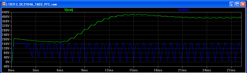

Yes I did, tried the circuit with LT8312 from #17. It seems to work there.

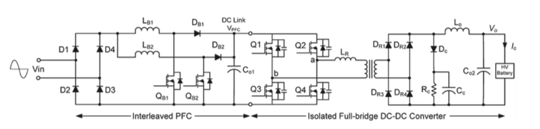

4. I added R3 because I want to make sure I have an input current of 16 A. D11, D12 is there because the circuit on configuration looks like that according to the scientist paper. But maybe they are not needed? See the attached files.
Thank you,
  • AnAutomotiveOn-Board3.3kWBatteryChargerforPHEVApplication_ NEW.pdf

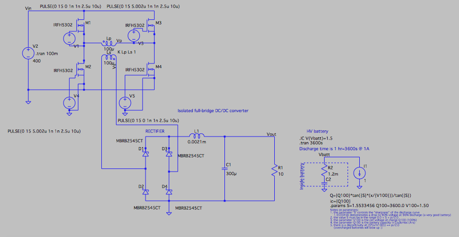

Aha, I see.
Hmm, it is possible to change some of the voltage sources with AC phase (180 degree) to the LT8312?
Cause I do not think there is an interleaved PFC controller for LTspice. I guess there is one for Pspice tough.
Okay, I will try that. But first, I felt I needed to go back some steps. So I now I focusing on 1-phase PFC (so no interleaved). I think I succeeded to implement a LT1249, and it seems to work.
I will try with the LT8312 as well and see how it goes.
But for the DC/DC converter stage, do you how to increase the voltage to around 30o V at the output? I got only around 200 V.
I need a voltage range between 320-380 V in order to charger the battery in vehicle. I tried to change many parameters in the circuit, but it seems not to increase.
If you have time, you can please have a look on that. I am so thankful for your help.

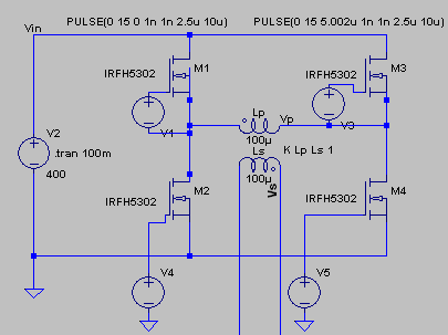

It is very common for people to think that if you put a voltage on the Gate of a MOSFET the transistor will turn on. The signal must be from Gate to Source. See the changes to M1 and M3 and how they connect to V1 and V3.
Next your transformer had problems. I changed to 1:1 transformer and increased the inductance.
Try this.

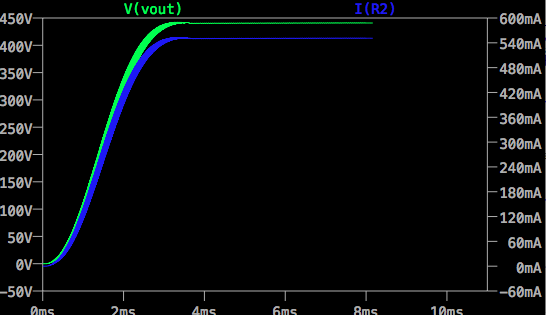

Ah, I see. But doesnt M2 and M4 also need to have the same connection as M1 and M3, regarding a signal from gate to source as well?
Okay, so the transformer should have 1:1 ratio. But I notice that, I could reach about 320 V output from the converter if the inductance been reduced, maybe that's what you meant.
Do you think the output voltage is DC enough in order to charge a battery? (I am however not sure about the battery model is correct, need to find one that is corresponding to a lithium battery for a PHEV).

Hmm, I don't understand why the circuits behave differently when I am just putting in the same file.
The AC/DC converter do not give the same output voltage, and likewise with the DC/DC converter.
Have I missed something?
Because, if these both converters operates properly, I was thinking to connect them together. But maybe that was too early I guess.
You had the bottom two MOSFETs correct. (either way you drew them will work)
Your top two MOSFETs were wrong. Then the Gate goes to 10V the MOSFET turns on and pulls it Source up to about 5V and then stops. The output of the bridge is; pull down good but pull up to only 5 volts).
Because you could only get 5V (in the old circuit) you changed the transformer to a very large turn ratio trying to amplify the 5V to get 200V.
"DC enough" I think some ripple on the output is OK. A car battery charger often does not have capacitors on the output. (very large ripple)
battery model
I have seen good batteries model. I often use a voltage source and a resistor (some times add a diode so it only charges).
Example: 12V battery like a car battery. I know at heavy charging current it will measure 14.5V. I often use a 12V voltage source and a 0.1 ohm resistor. At 0 to 12V the current is zero. At 10A charging current the voltage is 13. At 20A the voltage is 14V.

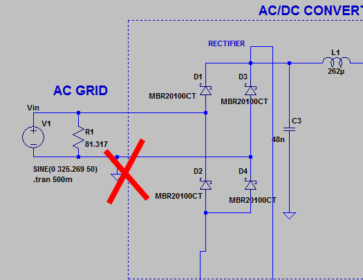

Look at the datasheet for the LT1249. It includes a typical application circuit.
I have checked that model, it should look something like this I imagine.
But can you check for errors please? I do not think it works properly, the output looks strange.
And about the input current? Do you know other ways to change the current? Cause my task is to make sure to that I have
230 V (rms) with an input current of 4 A, 6 A and 8 A. I must try for all of these currents. Thank you.
  • OFF_ACDC_4A.asc
Change the load on the output if you want to change the input current draw.
Your full wave bridge is not working. Remove the ground with the red X.
I do not know why R1.
It is not working right. It looks like the frequency response of the error amp is not right. C2,4, R3.
