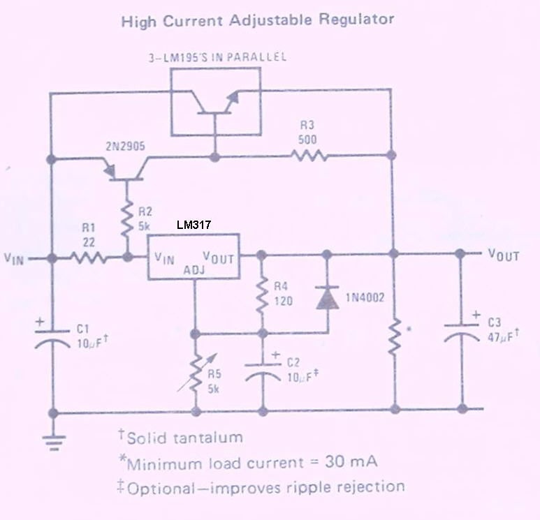

3 PARALLEL LM350's NOT WORK Properly.
Additionally Maybe not even one.
You Don't say What the Output Voltage of your Transfomer is?
First, At 9 Amps, You better have some Very Large Filter Caps to reduce ripple.
Second, These Devices are Rated at a Specific Amperage, Like 3 Amps for the LM350, BUT they are Also Rated for a Maximum Wattage. If the Wattage EXCEEDS its Limit, It will NOT HANDLE THE RATED AMPERAGE.
Third, You Better have some VERY GOOD HEATSINKS, no matter which way you do this. Or they WILL BURN UP.
Don't know where you got a price of $6.00 each, That is Awfully High Priced. I buy them for Under $3.00 each Canadian. (About $2.25 US)
Here is the Proper way to Increase Current of either the 317 or 350.[/quote]

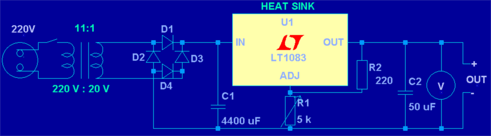

I found an heat sink that has 2 °C/W (Its specialy made for amps and power suplys)
Here is an datashet for the LT1083
It can handle 20 V (30V is max.) and there is a shematic how to wire two togeter.
Im planig a fan too.
I made an shematic.
It should work fine for currents up to and a little over 1 amp of load current. For output currents greater than that depending on the voltage you may have the ripple valley's in the output. The rule of thumb for filter capacitors is 3000uf of filtering per amp of load current.
I simulated it and the 4 400 uF cap cod stand up to 3A at 20V. So i will use an 10 000 uF cap (It did well in the simulation). Il use the higher curents to run big motors (over 3A) and smal ones to run circuits (up to 1A)so i neen stable power up to 1A (I dont care if the motors are a bit loud)
