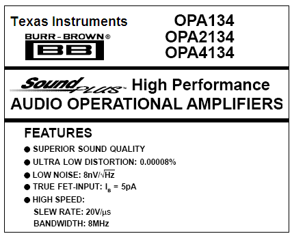

Plz sugges me the Superb Dual OPAMp for Audio use... (waiting for audioguru).
Thanks.
Hi Ayne,
The OPA2134 dual opamp is low noise and has only 0.00008% distortion.
