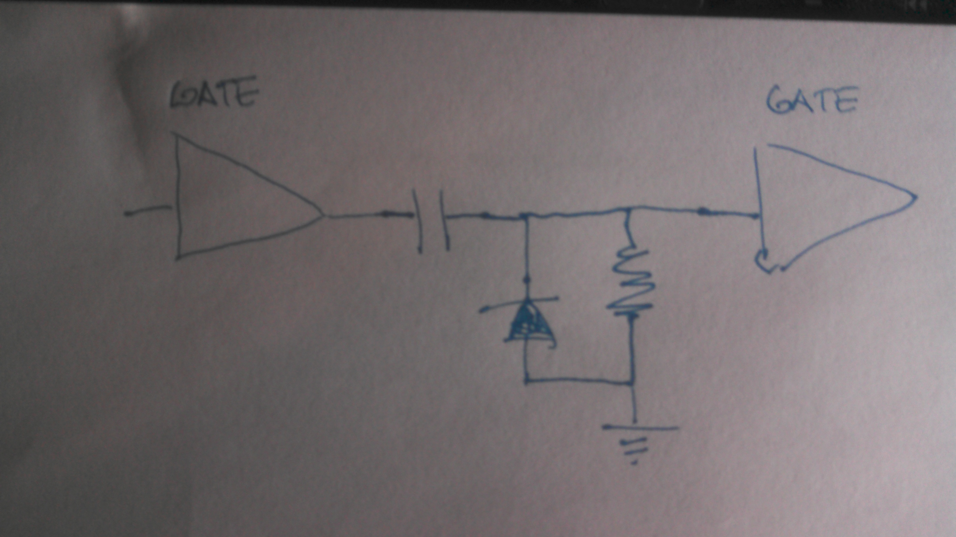

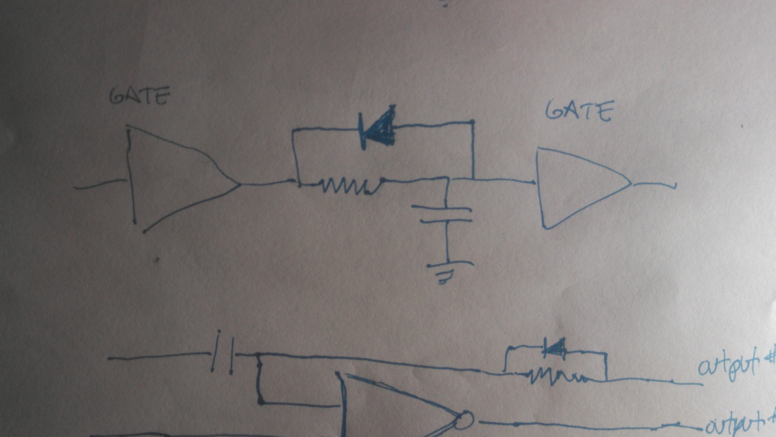

I have seen in logic circuits is they put an RC network only for the high state but for the low st state its straight to ground, why would u want the high states to have a delay time?
There is only an RC time delay only on the HIGH logic state , the low logic state goes through a bypass diode straight direct to ground
Why are these RC time delays used for logic HIGH states?

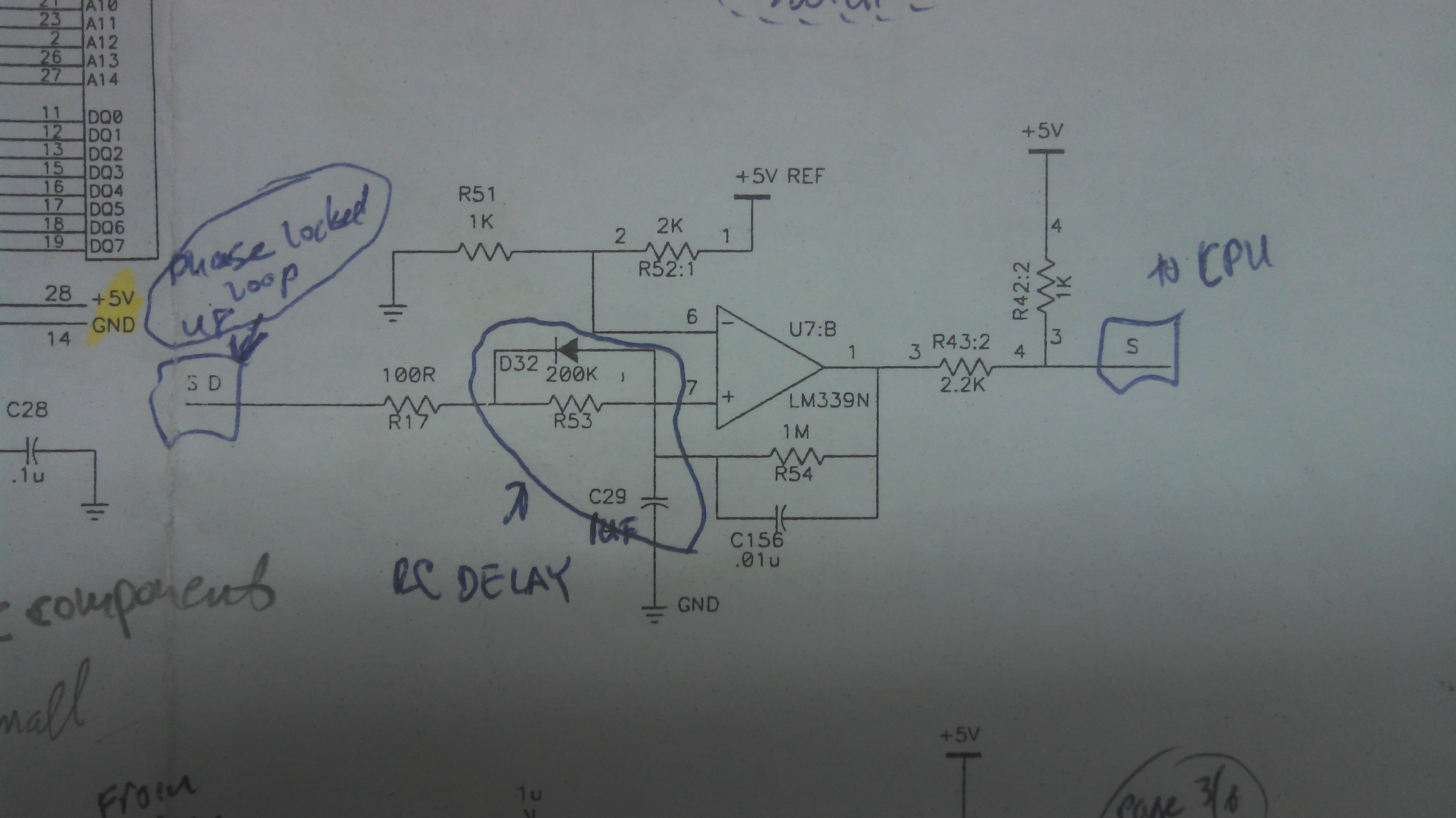

I've used the first circuit before. Basically I wanted over current protection for a motor for a model railroad (not mine). When a motor turns on there is a large current, so the RC time constant levels that out a bit. but once the motor was below the threshold, C would discharge immediately because of the diode. Now it would work if the motor slammed into the side.
This is a lot simpler than the logic to ignore the motor start pulse for 100 mS.

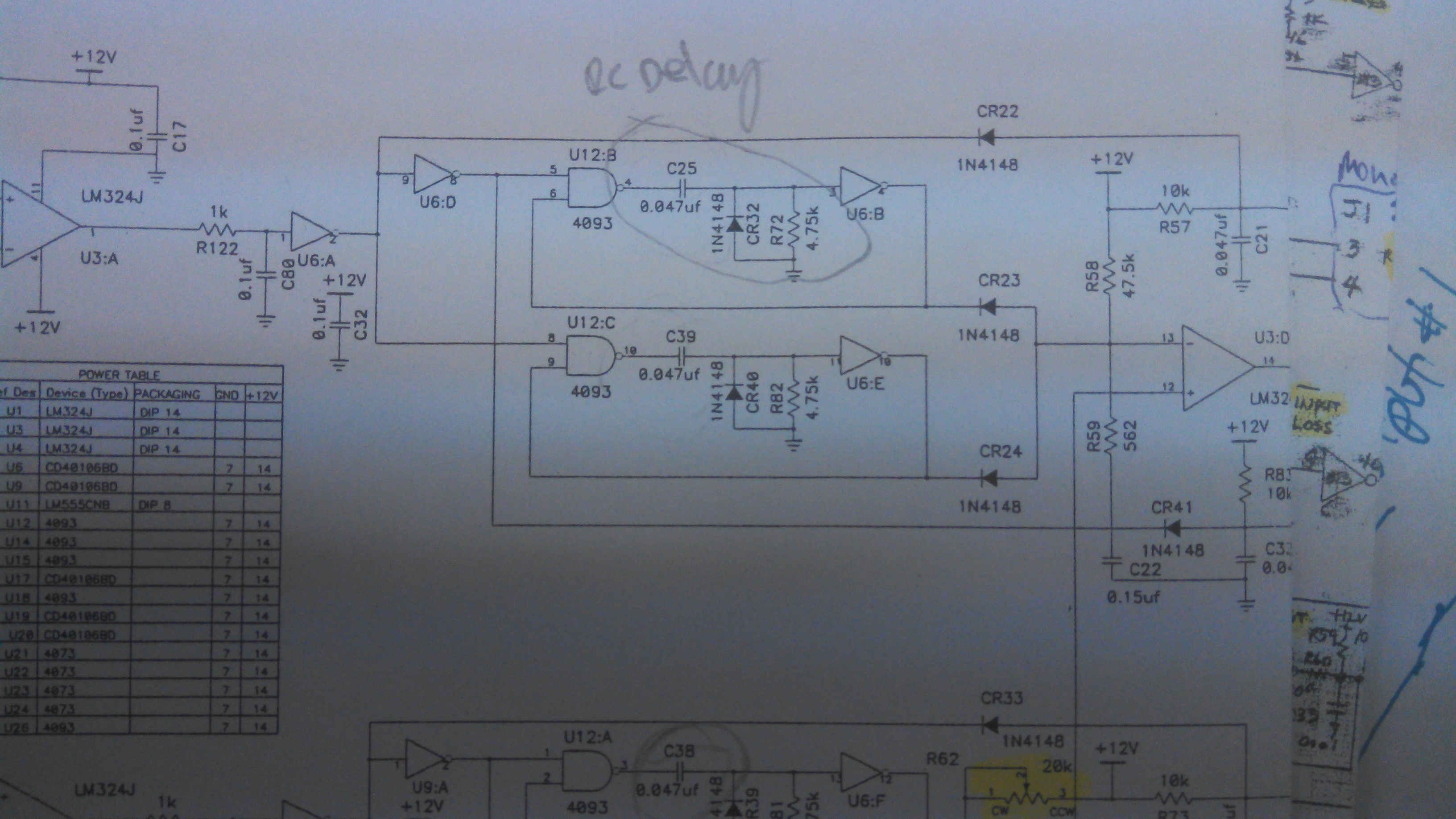

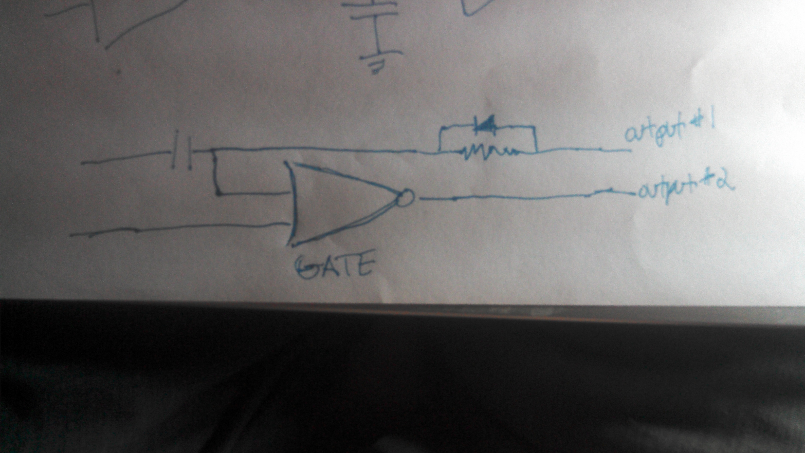

Here is the RC networks , only is for the HIGH logic state and the LOW logic state goes to the diode
What I don't understand is why does the HIGH and only the HIGH logic state need a RC time delay?
One of the diodes goes to ground and the other diode in pic#3 doesn't, it bypasses the RC network, how are they different?

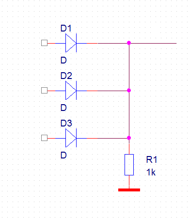

Those RC networks "waveshape" the logic high state going to a GATE , why would they want a shape trigger or waveshape going to a AND or OR GATE?
Take a look at this: high level on any of the inputs causes the output to be high. If you have low on all the inputs, then the resistor maintains logic low.
