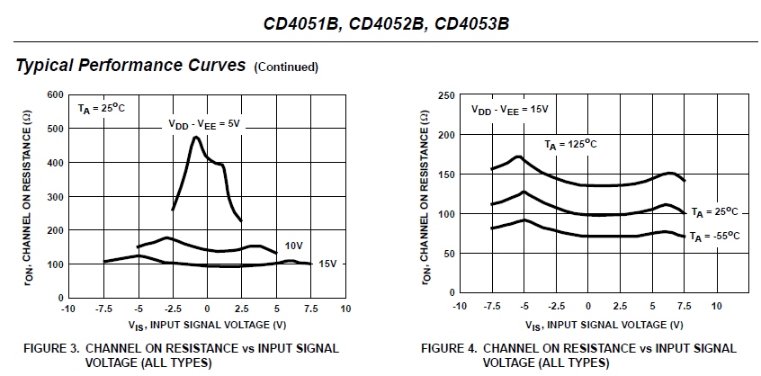

Ahh, yeah sorry, I should've stated it was being used as a switch.
Anything adds distortion. In this case it is small it you do it right. Then passing audio the MOSFET is on. It can not be a perfect switch. It might have 50 ohms on resistance. That 50 ohms and the 10k input resistance of the next amplifier makes a voltage divider where a very small amount of the audio is lost. This is OK. The 50 ohms is not constant under all conditions. Example: the 50 ohms (at 0 volts) might be 40 ohms with the positive half of the signal and 60 ohms with negative half. Hopefully the ratio of 50 to 10,000 is so small that 40:10000 and 50:10000 and 60:10000 all sound the same.
If I have time I will try to find real numbers tonight.
Below is from the data sheet on a CD4051 switch.
The right half shows resistance at three different temperatures.
The left half shows three different supplies voltages and what that does to resistance.
With a 15 volt supply at 25C and a signal of 0 volts the resistance is 100 ohms. If the signal is at -5 volts the resistance might be 125 ohms. This is non linear. If the next amplifier has in input of 100 ohms this causes large distortion. If the next amplifier has an input of 100,000 ohms this is almost no distortion.
Hope this helps!
