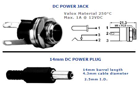

Now, I have been told to put a double power supplpier, i.e. battery and power line adapter (eg 6 V). Do you know some simple schematic in order to allow my box to accept both form of power supply. In particular, I would that the box automatically switches on the power from the adapter if it is inserted...
Use a power jack with a switch built into it. You plug the adapter into the jack and the jack's switch disconnects the battery.
It is very difficult to find a plug adapter with a jack, unless you build one on your own.
I would use a more electornic solution. For example, put some diode...
The problem is to have a solution as compatible as possible with standard plugs...
An adapter jack with a built-in switch is very common.
A new question
Thank you audioguru, I will search it in my local store...

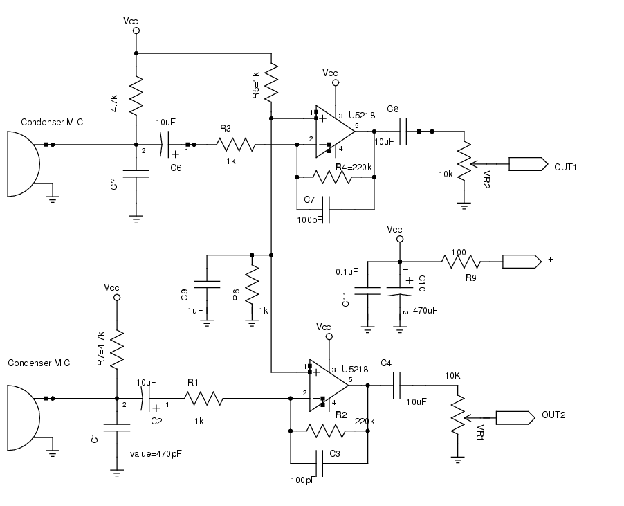

However, I put the schematic for the preamp I have been using.
Another question. I would use just one microphone, and not two, as in the schem of the preamp.
Can I remove the second mic and connect the signal of the first one to the middle point of C1-R7? I think no because in such way I will modify the impedences...
The preamp is a horrible design:
1) Its opamps are inverting which have a low input impedance (R1 and R3 which are only 1k ohms) that loads-down the fairly high microphone output impedance of about 3k ohms.
2) The values of many resistors are too low which makes the values of many capacitors too small.
3) C3 and C7 cut frequencies above 7kHz.
4) The microphone is called a "condenser" type by mistake when it is actually an "electret" type.
5) The IC is a dual opamp for stereo. A single opamp has different pins numbers.

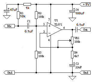

Here is a much better microphone preamp for a single microphone:

Not to mention the voltage divider biasing the op amps was drawing more current than was necessary (it was still a negligible amount, but 100K resistors were definitely an improvement).
The "horrible" original preamp circuit probably used a horrible LM358 dual opamp that is noisy and has crossover distortion.
Since we don't know much about the load, probably should put 100 ohms in series with the output to prevent oscillation.

Anyway, the PREAMP is working pretty well. Sorry, for the quick design,
I used gschem for the first time. The OPAMPS are the two you find in the 5218.
I did not check the cutoff frequencies, I will check.
However, the mic is really a condenser with two terminal. It has a FET preamplifier built in.
At least, the local vendors said to me that it is a condenser with two terminals.
Now, while I will try to implement the circuit of audioguru, may you suggest I to share the
input of the first mic with second stage? I need two output:eek:ne for the power AMP and one for the LINE....
I would like to know why the invering configuraiton is a problem, because in an audio amp the phase of the signal does not care. I think the designer put the inverting configuration to prevent oscillations
