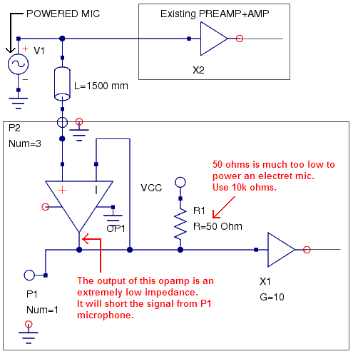

Ok, thanks audioguru.

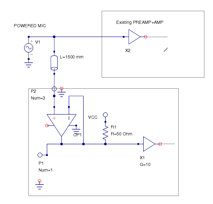

But to make a very flexible solution (the client is very fuzzy!) I propose this solution, with
two input on my box. One for pick up the signal from a powered mic, and the other for a non powered mic. (See the schematic)
What do you think?
G
May you suggest to me a simple power amplifier?
I have been using one based on TDA052 which is difficult to find here...
Regards
Your mic preamp with two inputs won't work. You cannot feed a signal into the extremely low output impedance of an opamp.
You need to have separate preamps for each mic then an inverting opamp as a mixer.

Two questions:
1) I wanna use one input at time
2) May I put a condenser between the output of the voltage follower and input 1 or
3) may I put a switch on the supply line of the opamp, in such a way that when the input 1 is inserted, the opamp will not affect
Regards
The voltage follower doesn't do anything except short the second input. A capacitor in series with its output would allow some low frequencies in but still short high frequencies.
You need a separate preamp for each mic then an inverting opamp as a mixer.

Sorry, if I insist.
But if I don't put anything on the Pin Number 1 (my mic), the ooutput of the opamp will feed my preamp, dont'it?
If I do not put anything on the second input, and instead I use my mic and also turn off the OPAMP, why the mic would be shortned?
Yes.
You don't want to feed a mic signal to the output of an opamp if it has power or if it doesn't have power. Use two preamps and a mixer circuit instead.

The output impedance (resistance to AC) of the opamp is so low that the signal coming from your mic is going to be shorted out to almost nothing by the very low resistance. Remember that electric current always takes the path of least resistance in proportion to all the resistances at that point in the circuit.
