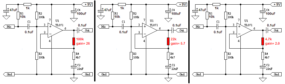

The pot in the preamp circuit adjusts its amount of gain. The TDA7052 amplifier also has gain. Your signal reduction ingress circuit should be a volume control that will adjust the volume from zero.
The preamp gain is set by the value of its pot like this:
again gain

However, there is a way to know which the peak-to-peak output of a typical electret mic?

The output of a mic depends on how far away from your mouth it is and how loud you speak or sing. A low load impedance reduces its level. It is typically about 14mV p-p.
