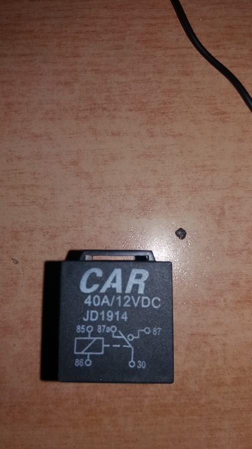

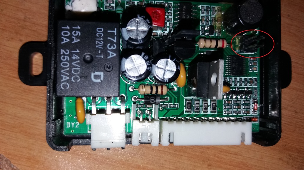

I have noticed that there are 4 four pins and there are no jumper on them. Near the four pins it's written "gnd swim +5V NRST"

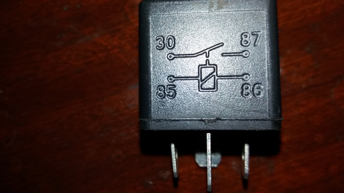

I have got 2 relay can I used them ?

The relays in the picture are not suitable. You need at least one set of changeover contacts. It is very unlikely that anyone will recognise your alarm so you need to find the manufacturer and get a manual. The diagram on the cover does not match the pins on the board.

Both of the relays in your pictures are single pole normaly open contact relays. You need change over contacts also called SPDT (Single pole double throw) NOTE a lot of the relays on ebay advertised as SPDT relay are only single pole normaly open contacts.
I will need to buy this relay, hope that it will work

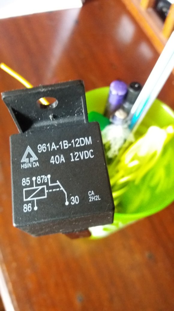

I have purchased 2 relays, here is the picture 20160305_084522 (Copy).jpg, I have wired it like it should but still it does not work
What have I done wrong again?
when you say you are getting 11.86 volts on the lock or unlock cables is this -11.86 volts with respect to + 12 volts OR +11.86 volts with respect to ground ? Could you hear a click from the relays when the lock / unlock outputs changed state ?
Les.
Baby steps:
Take 85 on both relays and connect to +12 always (e.g. alarm power)
Take 86 of the Lock relay and connect to the lock output.
Take Term 86 of the Unlock relay and connect to the unlock output.
Put your ohmmeter on pins 30 and 87a on each relay and check for a brief open condition when you toggle lock and unlock respectively.
The relay should click too.
Ideally, put a diode from pin 85 to pin 86 with the band facing 85. (This is for protection for the alarm electronics). It should be added, but strictly not necessary for testing.

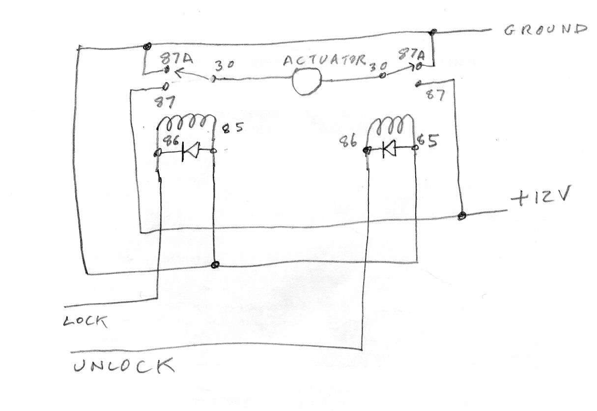

The outputs work the opposite way round to the the diagram on the case of the alarm so we need to change the way it is connected. This is the modified schematic.
Les.
Les:
Your schematic is wrong, again!
The alarm outputs (lock and unlock) are negative triggers not positive triggers. They really should be called ~LOCK (NOT LOCK) and ~UNLOCK (NOT UNLOCK).
It also MIGHT be REASONABLE to keep LOCK POWER and ALARM POWER separate. Do not know about that one. At least show it separately.
Pros or "Good things" (separate power): You'll know if an actuator is bad because alarm will not work, but the OP will likely know anyway because of buttons. If actuator wiring shorts, alarm still works without the door locks.
Cons "Bad things" (separate power): Can not think of one.

yash01's reply in post #54 suggests that the lock outputs go to +12 volts with respect to ground. (Not -12 volts with respect to +12 volts as we expected from the diagram.)

Go with the diagram. The "Ignition cutoff relay" is shown as (-) with the +12 and my alarm knowledge says it's likely (-) as well.
There are still translation (Google translate) issues.
There is also issues with us as to not being specific enough.
Black probe connected to (-) of meter.
Red probe connected to (+) of meter.
Disconnect anything going to the Lock wire on the alarm system.
Connect the red wire of the meter to some source of 12V.
Connect the black wire of the meter to Lock
Observe meter - You should have 0 Volts
Activate Lock - You should have "some voltage pulse" for a second or so.
The should have 12 V is ideal. You might actually have 12 V for this test in both conditions because of leakage currents, so nothing might happen.
