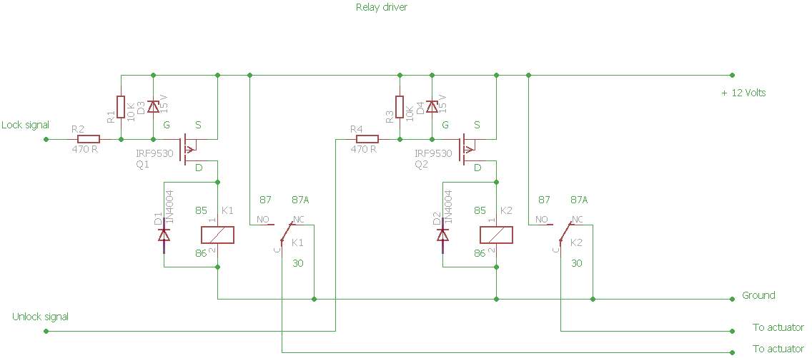

Hi yash01,
It looks like the output signal from the lock / unlock outputs is not enough to drive the relays directly. I will have to design a transistor driver that will provide about 250 mA to drive the relays. Probably Using P channel mosfets such as the IRF9530 would be the simplest solution.
Les.

Hi yash01,
Here is a relay driver circuit that should work.
When you are handling the mosfets take static precautions as they are sensitive to static electricity. The metal tab on the mosfet is connected to drain terminal so do not bolt it to metal that is connected to anything else. The mosfets sould not need a heatsink. The resistors and zener diodes are not required for the circuit to function. The zener diodes and R2 and R4 provide protection from transients. R1 and R3 hold the mosfet off if the inputs are not connected.
Les.

Hi KISS,
I agree. It is likely that the same design would have been used on all of the outputs so if that worked driving a relay then it would suggest that the lock and unlock outputs had been damaged. If it was either of us we would have traced the output connections on the alarm PCB to see what the ouput driver was. When I am buying a product I try to download the manuals before I buy it. I also try to find customer reviews of the product. I think yash01 may have given up on solving the problem as he has not posted for a few days.
Les.
