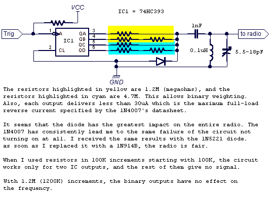

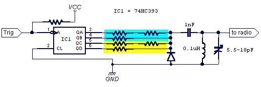

I made some changes to my circuit, and I have upped the resistance values, and I can't seem to get it to change stations. In order for me to change stations, I connect the TRIG input to ground, which creates a keypress.
The pull-up resistor is 27K.
The only diode that seems to work the best is 1N914B.
I think before I continue, I need to know:
1. what is the absolute MAXIMUM current the 1N914B can handle?
2. what is the absolute MINIMUM current the 1N914B can handle?
3. what is the absolute MAXIMUM voltage the 1N914B can handle?
4. what is the absolute MINIMUM voltage the 1N914B can handle?
I think that once I get the above 4 answers, I can adapt my circuit to any diode. what do you guys think?
and yes, a high coupling capacitor seems to make sense, so I'm going with 300pF to 1000pF.
btw, the rest of my radio circuit (including the shown tank circuit) works great.
I can easily tune by adjusting the trimmer, but I want to tune with the varicap as well.
someone please give me some insight.

mstechca said:
I can't seem to get it to change stations. The only diode that seems to work the best is 1N914B.
Of course it doesn't work. You don't have a varactor diode. You also don't have a power-up reset circuit for the counter so who knows what its outputs are doing? You also don't have a debounce circuit to clock your counter, so who knows how many times it gets clocked with each press of the pushbutton.

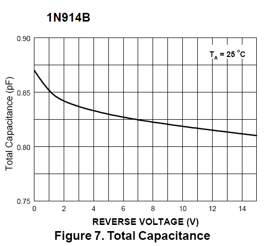

Look at the miniscule change of capacitance of a 1N914B on its datasheet.
It goes from 0.826pF at 6V to 0.865pF at 0V. That's nothing. You need a varactor to go from about 5pF to about 35pF.

Who cares about its forward-biased max ratings? They are on its datasheet. It is used reverse-biased in your circuit and its voltage rating is 75V and its leakage current is much less than 25nA.
The resistors at the output of your counter have values much too high so your meter will load down the voltage too much. Use about from 33k to 220k.

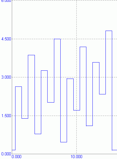

Your resistor does not do binary weithing. Frequency change is not progressive with trigger. Frequency jumps forward backward.
First of all you should use so called R/2R network to perform D/A conversion.
Your idea of changing frequency will give you about 800kHz shift in 16 steps. FM is 20.5MHz wide.

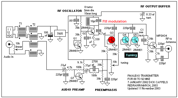

Didn't I post a circuit on one of your many separate posts where a circuit works with three 2N4401 transistors in parallel, used as varactor diodes?????
A station on the FM broadcast band is 150kHz wide. They are spaced 200kHz apart.

Using varicap diode is a must. Othervise you would not be able to cover entire FM band. Capacitance change factor from min. voltage to max. voltage must be greater than 1.7. Ordinary diodes have this factor much smaller.
If varicap diode is too expensive why did you spend so much money so far for a such project at all.

The diode is reverse-biased and doesn't draw any current (much less than 25nA!). If you want to monitor the voltage with a 10M multimeter without inaccuracy caused by loading then the resistors must be much lower than megohms. In your other thread I showed what happens if the resistors are too low in value like you had before. Didn't you try to measure the voltage steps?
As I mentioned the resistor network is wrong. Here is a pisture how the diode voltage will change with number of trigger pulses.

Because you've ignored almost everything you've been told, and ignored all the circuits that have been posted. You should have a single resistor (as shown in the circuit above) feeding the voltage to the varicap from the voltage source - this resistor should be VERY close to the varicap, and isolates capacitance changes in the resistor switching from the RF circuit.
according to logic, the answer must be that the diode can accept only current within a certain range. Am I right?
NO! - completely wrong, as you've also been told repeatedly, there's NO current involved, varactors work by applying a reverse bias voltage - and no current will flow, or there's something seriously wrong!.

No, as you've (yet again!) been told repeatedly, you need an R2R ladder to do that - your scheme just provides 'confusing' voltage changes, up and down - as bloki kindly drew.

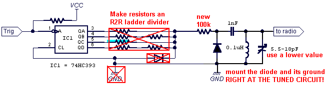

You do not need an R-2R ladder to make a simple D/A converter. The original circuit will work, but you have the bits reversed. You need the smallest valued resistor (R)on the MSB, 2R on the next bit, 4R on the next, etc. See the revised schematic below. The color coding follows your original notes. You can make a perfectly useable DAC in this manner, so long as you don't want to go too fast or have too much resolution.
Having said that, you will have tuning resolution problems if you want to make a receiver. You might get by in a simple transmitter, but your channel spacing will be non-uniform because of the voltage-vs-capacitance curve of the varicap.
Also, at zero volts bias, the sine wave on the diode will forward-bias it on a portion of each cycle, which will probably cause you all kinds of grief.
You would probably be better off to use 4000 series CMOS so you can build in a reverse bias at zero code to prevent this problem, and also get a wider tuning voltage range.

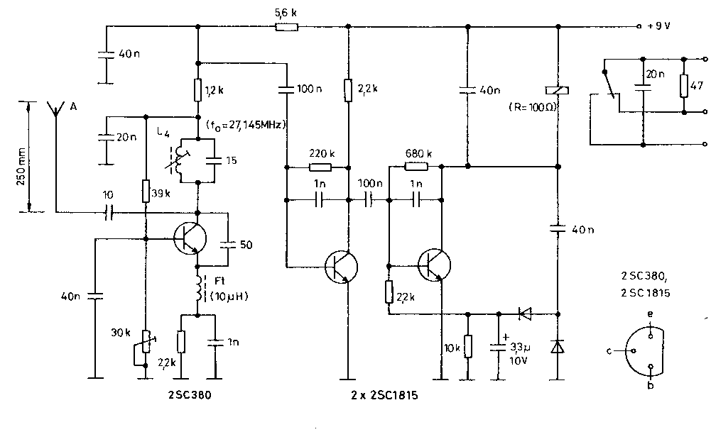

It doesn't use a varactor diode, but here is the familiar-looking schematic of a super-regen receiver in a Chinese toy car:

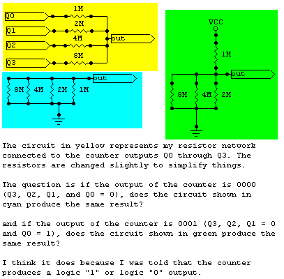

and check this attachment. Am I thinking right with the circuits below, or am I off?

Horray! Your yellow is an ADC!
Good going, MStechca! :lol: :lol:

don't forget to read the text in my attachment.
and you yaying at my yellow schematic is not yayable because the one before is the one I need improvements on.
I guess if you were yaying, then it means the other two schematics are correct.
