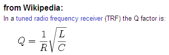

I went to Wikipedia, and they were talking about all the RF stuff I forgot about. They say:

This applies to series resonant circuits with a series R, or parallel resonant where the resistor is in series with the L or the C. It should be obvious that, for a parallel resonant tank with a parallel resistor, the Q is proportional to resistance, while in the case that you posted, it is inversely proportional to resistance.
Regarding √L/C, if you do the math for Fr=100MHz, L=100nH, you will find that this equals 63 ohms, which is identical to reactance of L and C individually. This is NOT the same as the impedance of the tank, which is, for ideal components, infinite at resonance.
