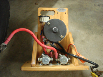

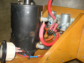

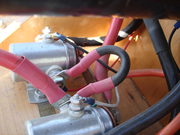

The problem with my diagram is that I don't know how to connect the relay with the momentary switch/DPDT switch combo. Do I need a solenoid for each direction or can I just use the relay? I've attached some photos of the big machines we use just for reference. Any ideas would help.

Where did those brown and green wires come from? They are not in the working schematic. The original schematic shows two wires from the motor. Reversing the motor should be as easy as reversing the leads to the motor with a toggle switch.

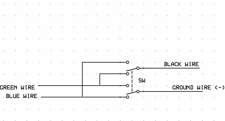

Based on the drawing in the link you posted, here is how I think the switch should be wired.
Let some others look at it before you rush and change anything, I have been wrong before. lol :D
Note that Blue and Green don't get connected, they just cross over eachother in the drawing.

Okay, guys... there are 6 wires on this motor; it is NOS and no longer made by Fasco, which is why you couldn't find anything on it. You're right - the colors are my mistake. That should be black and brown on either side of the switch and power (-) to green. I'll switch that - thanks!
