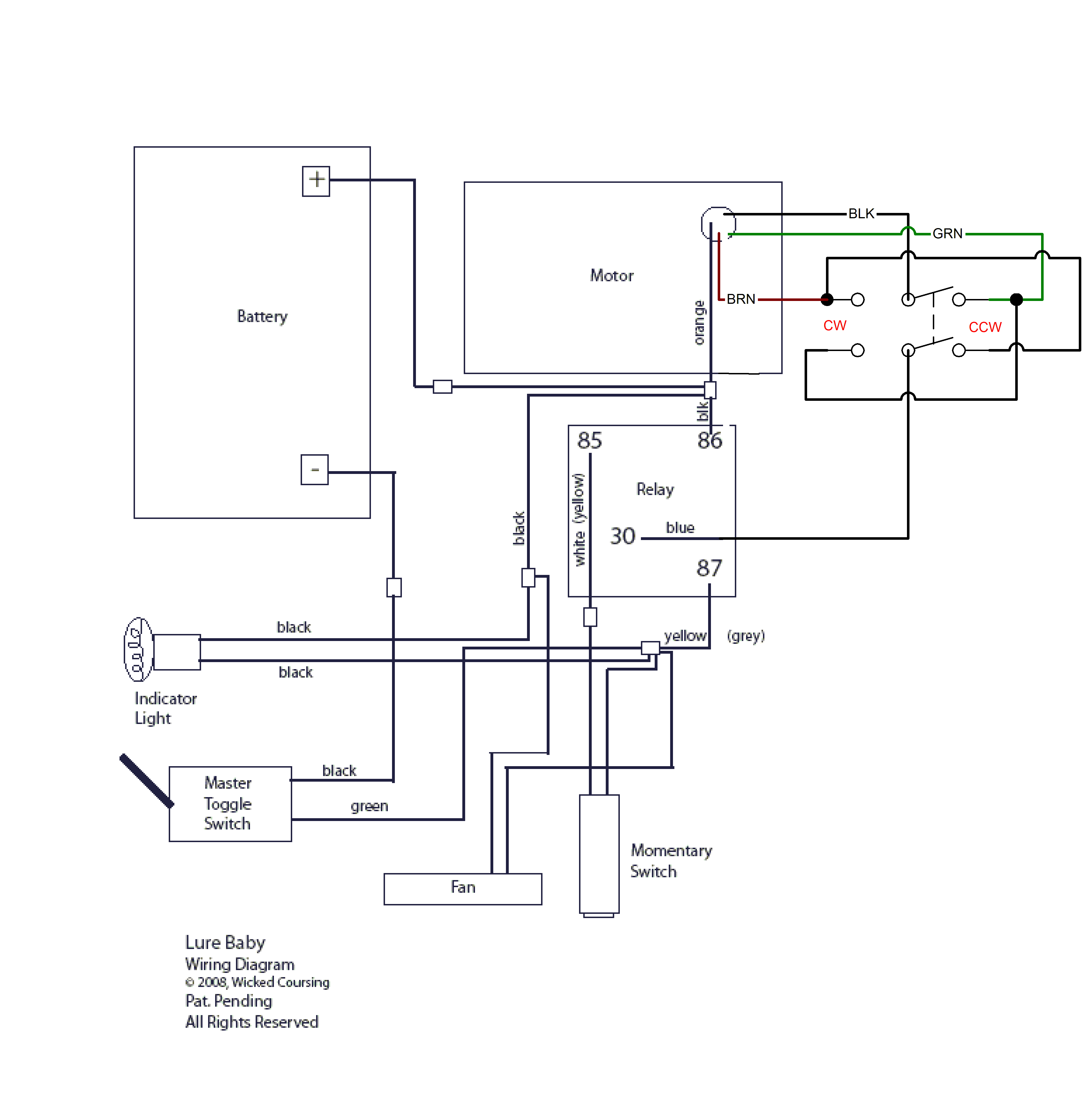

So, green is always grounded and grounding black also, makes it spin one way, and brown the other? Is that correct?

Yup, that's it.
Yeah, the initial motor will cost me about $60 but after that they'll be around half that for production. Way cool!

The attached file is what I come up with. This is based on the info you provided from the label on motor. I figure that has to be pretty accurate.
That's really cool! Thanks!!!! Doesn't the momentary switch need to be wired into the dpdt switch somehow? On the big field machines it is, so I thought that's how it had to be. But then, they don't use a relay, they have 2 solenoids. Maybe I should just leave well enough alone...:eek:
I'll get this thing wired up over the weekend and let you know how it works. Thanks, again!
The momentary switch will still energize the relay, just like the unit in the unmodified wiring diagram you provided. Just put the DPDT switch in CW or CCW position and press the pushbutton. The motor will run CW or CCW depending on where you set the DPDT switch.

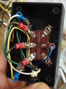

Okay, here are the photos. So far the nothing at all works except the relay is clicking on with every depression of the momentary switch. The motor doesn't run in either direction. I believe I have not put power where it needs to be but can't figure it out....:confused:
Thanks, again...
If that's a reversing switch, you need that brown and green repeated on the diametric opposite sides of that DPDT switch.
...so when black contacts brown, blue contacts green, and vice-versa.
Okay, I know this will sound dumb, but what exactly does that mean? Do I run a jumper across the corner terminals or just connect one of the other wires in the cord to the terminals at one end and the brown & green wires at the other? Very challenging doing this kind of work without an electrical or engineering background!! :mad:
Jumper across the corner terminals. Look at that diagram from ccurtis on the previous page. It shows the brown and green jumpers on the reversing switch.

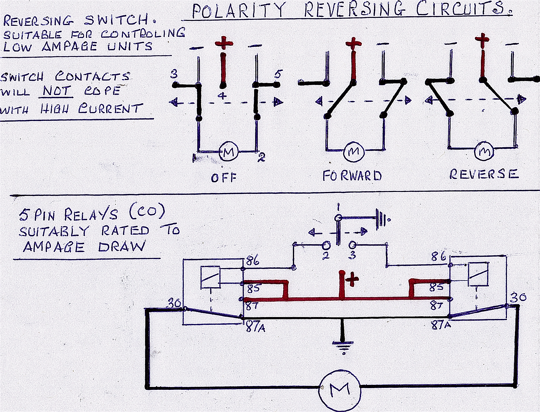

Polarity reversing
Reversing polarity should be quite simple,Two suitably rated 5 pin relays(CO),& a 3 position switch.If you want to control the speed use a PWM,capable of coping with the Ampage.
