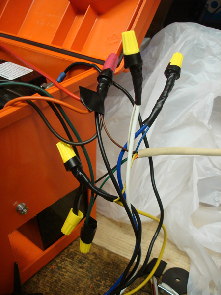

Duffy is right, chasegirl. Your picture doesn't look like the wiring diagram I posted. Two terminals clearly have no wires on them at all, and the wires you do have there don't match the orientation in my diagram. Though your orientation looks reversed from my diagram, and may not matter, why take chances? What are you drinking? :D
Look at the bottom of your switch, just as in your photo, and match it exactly to the diagrammatic picture of the bottom of the switch in my post.
Okay, so jumper across - brown straight across to the opposite terminal and green straight across to it's opposite?

What about the power situation? Wouldn't the motor run at least in one direction without the jumpers?
Hahaha. Just kidding, ya know.
No, the motor won't run without at least one of the jumpers in there. Wire them all up, why don't ya? It's not going to bite. You have a pushbutton switch. Just hold it for a short moment, for a quick smoke test.

Okay, Ccurtis, et al: I put the jumpers on and voila - one side works!! The green side doesn't however - I know there's no power to green but I'm not sure how to connect it. You can see in the photo that I've got green on the motor to green in the cable (to the switch) but nothing else. Should I have an additional lead from the battery and the black motor lead to green?

What is that brown wire doing in there with the red,blk,blk, and org wire???
Take a deep breath, relax. Print out the diagram. Go through every single wire and check them off on the diagram, one by one. It's kinda tough to do that with only a picture of part of it, but that brown wire in with the other four doesn't belong there from everything I have from you. That doesn't necessarily explain why the other direction doesn't work, but it sure puts doubt into the overall correctness of the wiring and/or information I have from your previous posts.

Okay, ccurtis - here we go again! I put the brown, green, black and orange together because I (clearly) didn't understand your diagram. There's one orange and one black coming from the motor, so how do the green and brown connect? Brown and orange, and black and green?

Well, I am getting a little frustrated over here. I need to make this d*$!n thing run... but at least one direction is better than nothing! Also, ccurtis, it's running toward the brown, not the green, which is, I think, CW.
The green and brown wires come from the motor and connect only to the switch terminals. Then there are the green and brown jumper wires that get added onto the switch terminals. They should go to no other place. That's what in the diagram, right?
I'm at a loss over here. If everything is connected as in the diagram and it still doesn't work, I am out of options on how to proceed.
Chasegirl, do you have a voltmeter? Trace the voltage through. Start at the battery, and go all the way to the motor. Find out where you are losing the voltage. When it's working, you will see the voltage across the motor. When it isn't, you will see the voltage stop at a switch or relay or something.
Hey, Duffy - yes, I have a voltmeter. My partner finally sat me down and worked through it with me. The jumpers were straight across instead of across the corners and I had the brown lead in with the power and motor leads (as you mentioned, ccurtis). So - it finally worked!! Thanks to you and ccurtis for sticking with me on this.
