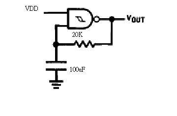

for calculating the 2sec clock pulse i can use the forkula of T= RC
so 20K resistor and 100uF capacitor should give me 2 sec clock pulse?
is this right????
is this right????
Thats a good starting point, if you use a 100uF cap say, an electrolytic, it could be +/- 20% tolerance!
If you need a clock close to 2sec I would suggest you make the 20K a 50K variable, so that you can trim the time.

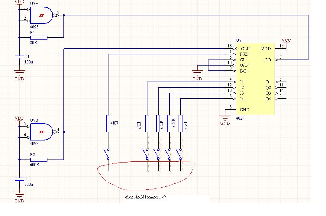

Check out the simple sirsuit i have come up with can someone tell what have i done wrong?:confused:
now the question is where do iconnect the buzzer?

Whats the 4093 osc meant to do?
See my drawing
The 'load' switch is a 'momentary push button', the other 4 switches are latching/toggle normally closed.
Whats the specification of the buzzer and when is it supposed to buzz:confused:

The problem with your circuit is the oscillators, they never stop running.
If its a buzzer with an inbuilt osc, that makes a tone when a dc voltage is applied, every 2 secs it will buzz then stop for 2sec and keep repeating forever!
The same applies to the minute osc, its always running!.
You need to construct a latch using a 4093, when the 'load' button is pressed the time switch settings are loaded into the 4029
and the1 min osc starts.
When the /TC goes low it resets the latch and stops the 1 min osc, also /TC going low triggers a 2sec monostable [using 4093s]
and the buzzer sounds for 2 sec.
Is this clear?
EDIT: added an example circuit
