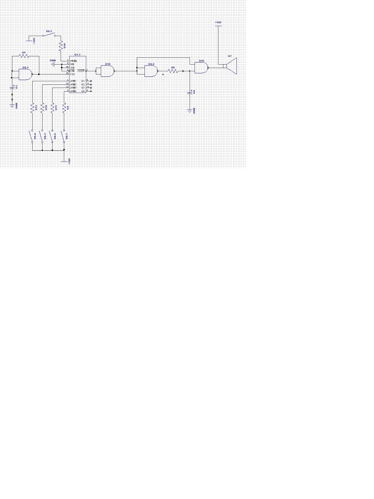

try this must work

The circuit posted by 'pumpo' looks OK, but its not complete.:)
I would add pull down resistors on the four JAM inputs and th PLoad.

4510 Ic
Hi
My teacher could not find 4029 so he asked me to use 4510 IC's presettable updown counter. So now I have to use 4510.
I was wandering do I have to to make any changes to the to the circuit diagram that pumpo had advised.??
and since it is 4510 is pin 7 a not gate ? or not?
and e.g for pin 9 B/D is used. Is it the same as resit?
and by putting pull down resistors will teh circuit be complte?

Hi
Could you please describe all the markings given in your circuit. for example what is u1.1, u2.1 etc
help would be appreciated.
and I was wondering do I have to to make any changes to the to the circuit diagram that pumpo had advised.??
and since it is 4510 ....its pin 7 a not gate ? or not?
and e.g for pin 9 B/D is used. Is it the same as reset?
can the circuit given by pumpo can also work on 4510 instead of 4029.
