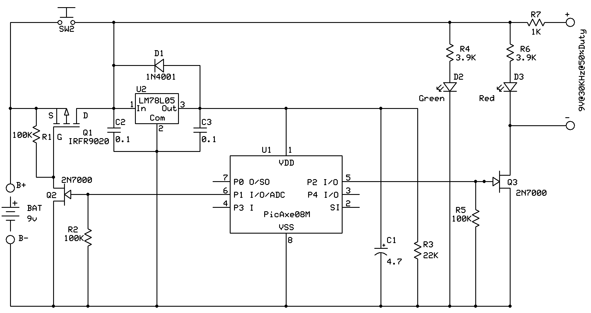

Ron,
Think this will work for low side switching? No more 555 circuit. I needed to change the output to P2 for PWM.
Ken
Start:	'Turn on power-hold circuit
	High 1
OnOffOnOffOnOff: 'Operate pulser output circuit at 30KHz @ 50% Duty Cycle
	pwmout 2 , 32, 67   ‘ Pulses on P2 transistor output
  	for b1= 1 to 10
   	 wait 60   ‘ waits 60 seconds, 10 times (10 minutes)
 	  next b1
	pwmout 2 , 0, 0   ‘ Stop pulses on P2 transistor output
  	for b1 = 1 to 20
  	 wait 60   ‘ waits 60 seconds, 20 times (20 minutes)
  	  next b1
  	for b1= 1 to 10
 	  next b1
  	for b1 = 1 to 20
 	  next b1
	for b1= 1 to 10
	  next b1
Terminate:		'Turn of power-hold circuit
	Low 1
	Stop
Ken, I never read the other thread, and I really don't want to go back and read the whole thing. :(
Is Slopagafud trying to replace the purchased Zapper with his own design? In this thread, all I got was that he is wanting to switch the Zapper on and off with the PIC. Your new schematic looks OK, assuming that the Zapper doesn't have a transformer or some other high-voltage generating scheme. Do you know that to be the case?
Ron,

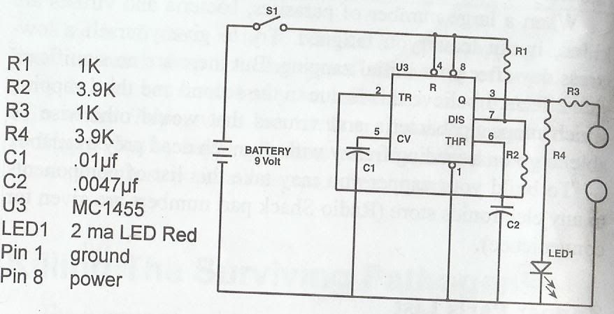

Slopagafud (Dan) built his own Zapper. Just a 9v 32KHz 555 astable output through a 1K resistor through a load to ground. I got in when he asked for a way to automatically run it for a series of on-off periods and shut down. I had made an auto shut off in a PICAXE circuit, so he was building on that, with someones timing loop program. I sort of messed him up when I forgot about the diodes on the PICAXE I/Os. The last circuit should eliminate the 555 portion all together.
Ken
The schematic I posted is scanned directly from the book "The Cure For All Diseases" by Hulda Regehr Clark Ph.D.,N.D.. She developed the device. It is the baseline ALL zappers are built from.
