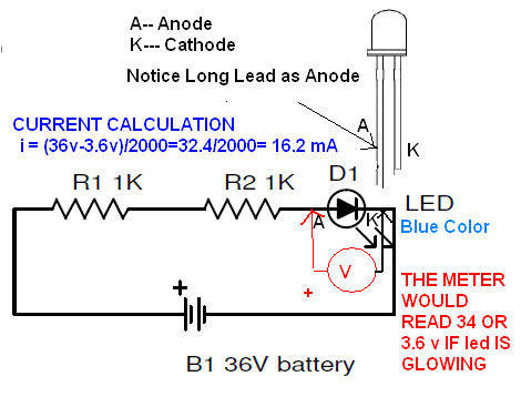

Complete rookie here. I know absolutely nothing about electronics, but I'm trying to learn as I go.
I'm trying to build an LED that replaces the buzzer on my Golf Cart. The problem is that everything on a golf cart is 36 volts, including the buzzer. I removed the buzzer and just left the leads disconnected, and everything works fine on the cart, but I can never tell when I'm in reverse, so I want an LED.
Here was my brilliant idea, feel free to frame this artwork...
The volt meter is only there for testing. So before I hooked up the LED, I tested as the voltmeter shows, from the resistor to the negative, to see what voltage the LED would be seeing. To my surprise, it was still the full 36 volts. It didn't matter if I had the resistors in there or not, the volt meter still sees 36volts.
The resistors are 1kohm, 1 watt, 5%, and wired in a series.
Any sort of direction is a step forward because I'm clueless.
Thanks, and sorry to clutter up the forum with elementry questions.
The meter will see 36V because it's only drawing a tiny current. Look up Ohm's law, V = IR, the current through the 2k resistor (two 1ks in series) is negligible so the voltage across them will be nearly 0V leaving 36V for the meter.

To calculate the resistor use the following formula:
[latex]R = \frac{Vin-Vf}{If}[/latex]
In your case the current will be 16.25mA, assuming you're using a blue LED with a forward voltage, which is fine.
[latex]I = \frac{36-3.5}{2000} = 0.01625A = 16.25mA[/latex]
The power dissipated by each resistor is equal to the following formula:
[latex]P = I^2R = 0.01625^2 \times 1000 = 264.06mW[/latex] which is fine, indeed you could use a single 2k 1W resistor.

I'm beyond clueless on this, but learning slowly. I think last night I expected the resistors would drop the voltage down, which I guess really doesn't make sense, but I think I expected they'd use up the voltage and the meter would show like 5volts for the LED. :o

Resistors drop voltage you are right. BUT only when a current passes through them? Read fundamentals
P S: the meter will have its resistance in MEG ohms. when you connect 2 nos of 1K in series to the meter, it doesn't matter for the meter and it will still read same voltage , through theoretically less by few micro volts. so in you new diagram without LED also the 36 is read a almost 36.

I see clearly what you mean now! Good plan of yours that is, checking the circuit first before connecting the LED. Yes, that's a reasonable assumption to make, that the resistors 'will drop voltage', just like a pressure regulator will drop PSI. Wrong of course, but reasonable. ***The resistors only drop voltage when there's a significant current flowing through them*** A volt meter takes hardly any current at all (that's the whole idea of a voltmeter by the way)

The schematic is here . I hope the therealciviczc is accustome to read the electrical schematics.

Thanks sama with your schematic which is correct.
one error (34) should be 3.4 Volts.

It will read 36V because there's no current flowing through the resistors. I tried to explain this in my previous post.
Your meter probably has a resistance of 10M, look up potential divider on Wikipedia and you'll discover that this is what you should expect if you connect a 10M digital multimeter to a voltage in series with two 1k resistors.
https://en.wikipedia.org/wiki/Voltage_divider
R1 is the two 1k resistors in series; this makes it 2k.
R2 is the multimeter, let's assume it has an impedance of 10M.
Plug the figures into the potential divider formula and you'll find that Vout is so near Vin that you won't be able to measure the difference using a multimeter.
[latex]V_\mathrm{out} = \frac{R_2}{R_1+R_2} \cdot V_\mathrm{in} [/latex]
