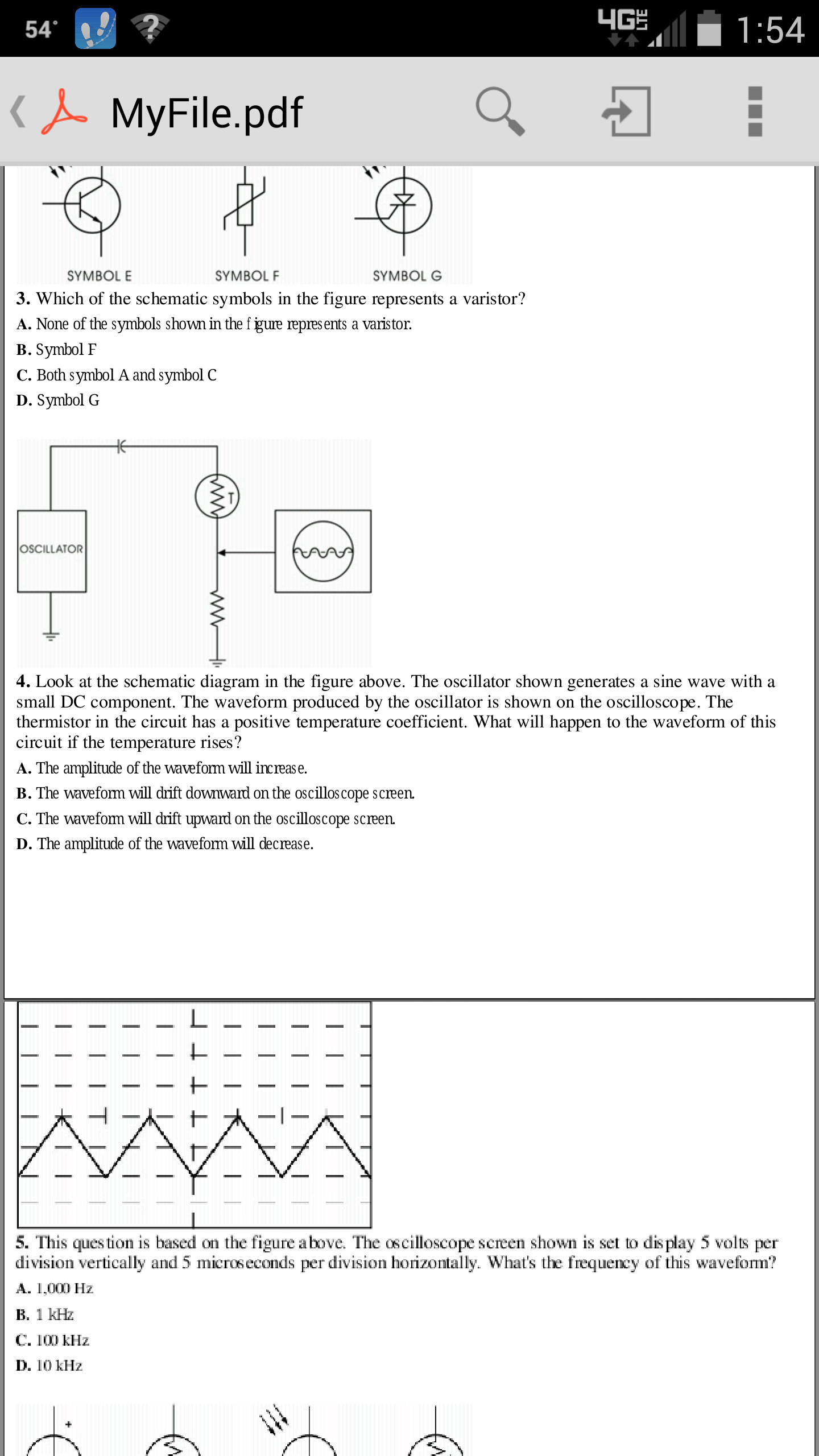

Hi JimB, well just the fact that I dont understand what the waveform would do?
I also think that its D in the answer as well?
Thanks in advance for any and all responses
Corey

The oscillator generates a sine
wave with a small DC component. The waveform produced by the oscillator is shown on the oscilloscope.
The thermistor in the circuit has a positive temperature coefficient. What will happen to the waveform of this
circuit if the temperature rises?
A. The amplitude of the waveform will decrease.
B. The waveform will drift upward on the oscilloscope screen.
C. The waveform will drift downward on the oscilloscope screen.
D. The amplitude of the waveform will increase.
I think its D, correct or not enough info?
B since it is DC biased PTC means if polarity is correct, the voltage will drift up as there is no waveform. Correct polarity means if a constant current is provided from constant V to an equalt or midscale thermistor value R then to thermistor, if R of thermistor increases with temp, so will voltage. Normally thermistors are rated at 25C for R, which is the fixed value you would choose in series from V+ if you were interested in measuring around room temp, +\- x deg C
Here hopefully is a screenshot. Question number 4.
See if I'm right but now also looking into Tony Stewart's post.
Corey
Ah sine wave source and PTC on top side so inverted response.
D you are correct.
