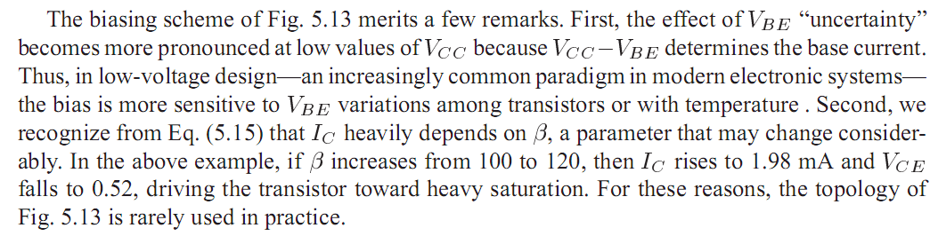

Thank you so much, MrAl. I think you're right, it seems that one of my biggest problems is that I'm not always being able to express my questions clearly.
Here my question arised from a statement, as shown above, from my textbook and I want to realize what it means: in low-voltage design, the bias is more sensitive to Vbe variations among transistors.
I also have to admit that I didn't understand what 'context' meant when I first read it in post #13
I should also note that we have to understand the context of this analysis, where we are looking at a certain kind of change for a certain reason.
Now I see what the context is, and I need some time to digest it. Thank you!
Here is the context...
You are given a task to complete, you have to design the bias circuit for a transistor that has a DC current gain of 10, and you have to bias the output to 5 volts, and the circuit should not draw more than about 100ma. You can however choose any Vcc you want from 5v up to 25v, any base resistor, and any collector resistor, but you have to design it such that the bias point change is minimal with any change in Vbe (from temperature or change of physical transistor). What Vcc, what Rb, and what Rc do you use in order to keep the bias point as stable as possible with change in Vbe? The transistor model you are allowed to use is the current controlled current source where the input of the current source is in series with a small battery which represents Vbe and is around 0.5v. Since the gain is 10, that means if you input 1ma into the 'base' you always get 10ma through the collector, just for example.
To make this even simpler though, we are given only two choices:
1. Vcc=10.5v, Rb=2000 ohms, Rc=110 ohms
2. Vcc=20.5v, Rb=4000 ohms, Rc=310 ohms
Which of these two circuits keeps the bias point more constant when Vbe increases by 10 percent, #1 or #2 ?
Note that both circuits provide a 5.000v output with Vbe=0.5 volts.
Also note that with Vbe=0.5v that means in #1 we have 10v across Rb, and in #2 we have 20v across Rb.

I'm still wondering what the remarks in my textbook really mean, "in low-voltage design, the bias is more sensitive to Vbe variations among transistors"? The 'low-voltage' design seems to mean at lower Vcc to me, and our two examples show the bias point is more stable with higher Vcc.

I'm still wondering what the remarks in my textbook really mean, "in low-voltage design, the bias is more sensitive to Vbe variations among transistors"? The 'low-voltage' design seems to mean at lower Vcc to me.
It is intuitively obvious that the more insignificant Vbe is with respect to Vcc, the more Vcc is going to be the primary control of Ib. Making Vcc as high as possible makes changes in Vbe more insignificant.

So, can I say "in low-voltage design, the bias is more sensitive to Vbe variations among transistors" means at lower Vcc, the operating point variation is higher/wider due to a same amount of variation in Vbe?

Now I realize it's English, and perhaps my ability of reading. I was not able to understand, or misunderstood what "more sensitive to variations in Vbe" means.
Thanks to you and Ratch, the mystery has been solved!
