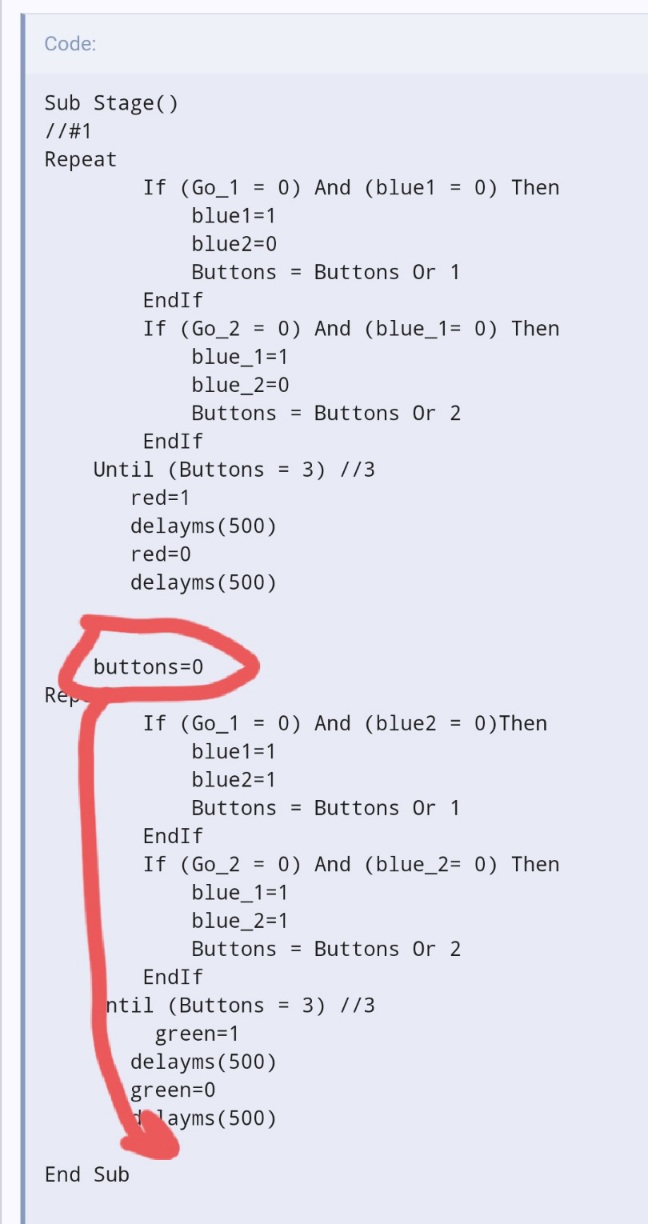

personally, I'd set it at the beginng so you're not at the mercy of someone using it before calling Stage()...
Sub Stage()
buttons=0      // init buttons BEFORE entering loop
Repeat
    // first loop goes here...
Until (Buttons = 3) //3
Repeat
    // second loop goes here...
end sub
I have the code set up as in post 63 and int buttons at the beginning as in post 63.
The leds indicate the code is progressing but the code reverts back to the first loop? as in post #60
Putting the leds to track code progression was one of Jon's ideas wayyy back when. It helps
See in the big red circle how you reset buttons =:0 after the first repeat/until loop?
Follow the big red arrow. Notice how you don't reset it after the second repeat/until loop?
So the next time you get to that subroutine, what happens? Whether or not the buttons are pressed, buttons = 3 and the red LED turns on.
Tumbleweed is also reseting buttons =:0 for each repeat/until loop, just in a better way. Either will work. Time to THINK about how the code reacts.
That's YOUR assumption as to what's going on.
I seriously doubt that. That's why I asked for the ENTIRE code in its current state.
I'm not going to try too hard guessing... for example what's the difference between 'blue1' and 'blue_1'???
Also, now that you have the Stage() subroutine, a better way would be to get rid of the global
'buttons' variable entirely and use a local variable inside the sub.
You'd still be relying on the state of a few other global variables/leds, but that's your problem.

here is my entire code. Am rethinking about the code as is. It appears to work but?

Did you even attempt to understand this?
Or the clarification here? I typed it really s l o w l y so you could understand.
But in the code you just posted, the one line you needed to add STILL isn't there.
**SIGH**
You mean the one that makes it work? The one that SETS BUTTONS=0 BEFORE CALLING STAGE() A SECOND TIME?
**SIGH**
Yeah, that would be the one....THE ONE SPECIFICALLY ASKED ABOUT IN THE LATEST VOLLEY. I know nothing about the rest of the code. It's hard enough to follow other people's code when there is SOME LOGIC to it. When it's a incomprehensible nightmare that follows no rhythm or reason, when any advice given given will be ignored anyway, it's just not worth the effort AGAIN.
Oh, I see now. You're talking about the ONE LINE THAT THIS ENTIRE PAGE OF POSTS HAS BEEN POINTING OUT.

Sub Stage()
//#1
index1=0
Repeat
        If (Go_1 = 0) And (blue1 = 0) Then        // player1 button press...
            blue1=1
            blue2=0
            index1 = index1 Or 1
        EndIf
        If (Go_2 = 0) And (blue_1= 0) Then        // player2 button press...
            blue_1=1
            blue_2=0
            index1 = index1 Or 2
        EndIf
    Until (index1 = 3) //3
       red=1                  //  code progression indication
       DelayMS(500)
       red=0
       DelayMS(500)
//stage#2
index1=0
Repeat
        If (Go_1 = 0) And (blue2 = 0)Then        // player1 button press...
            blue1=1
            blue2=1
            counter1=1
        EndIf
        If (Go_2 = 0) And (blue_2= 0) Then        // player2 button press...
            blue_1=1
            blue_2=1
            counter2=1
        EndIf
