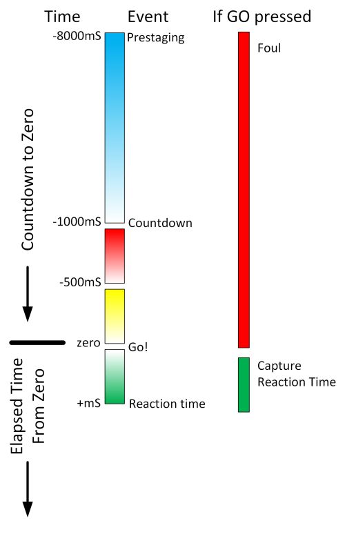

Ok, this just got much easier. Back with an illustration shortly.
This is a simple, very linear task, as shown by the illustration. The exact sequence and timing of the LEDs may need to be adjusted because I've lost track, but follow along.
Set the mS variable to –8000, the total time of staging, red and yellow LEDs before the green LED is illuminated. When staging starts, increment mS. It will start counting up towards zero (i.e., –7999, –7998, –7997...)
The blue LED is illuminated until mS > -1000
When mS reaches –1000mS, the red LED is on
When mS reaches –500mS, the yellow LED is on
When mS reaches zero, the green LED is on
Note: the above lines are literally 4 if/then statements.
During this entire event, the go buttons are monitored. When a button is pressed, mS is captured, and any addition presses are ignored (got to love me some boolean you know). If mS is negative, it's a foul. If mS is positive, it's the reaction time.
That's a total of about 8 if/then statements in the main program loop, plus a sub routine to display the results.
Why would you want to ruin this with a simple, concise, and understandable example of the desired results?
Although I did give you a thumbs up for the effort!
It's a pretty straight forward task once you understand exactly what's needed.
There are variations in how many lights illuminate in what time intervals; it would be pretty simple to code for all the options.

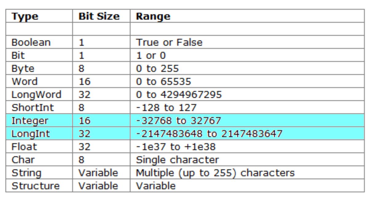

In the interest of heading off "I tried this but it didn't work" creativity, the variable type used for mS in my scheme must support negative numbers, i.e., be either INTEGER or LongInt type.
I like the description that Jon posted but need to decipher why go with negative numbers? Just asking.

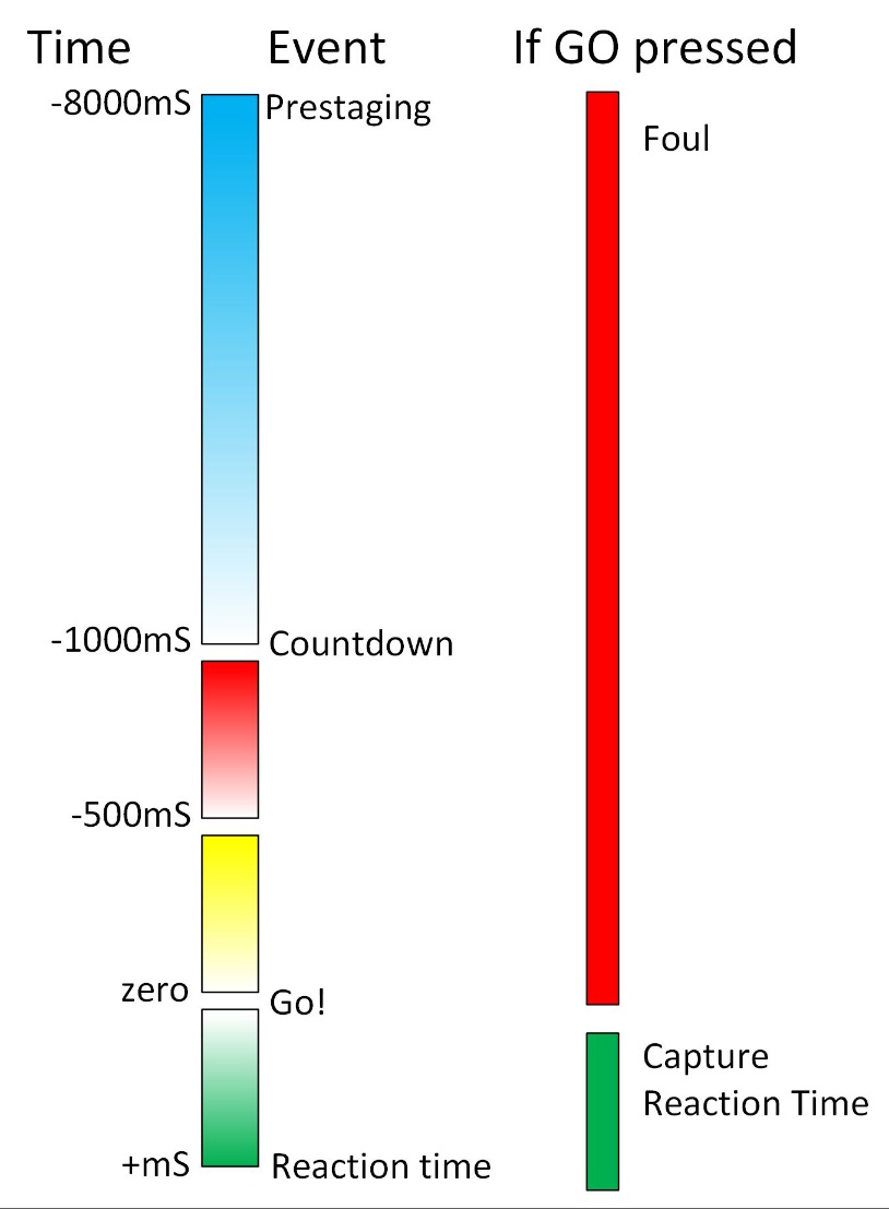

I believe my explanation about is clear and concise. But to make it more so, added a few words to the picture.
I am trying to use Jons advice but it won't compile?
-7000 do I need to use it as an integer?
