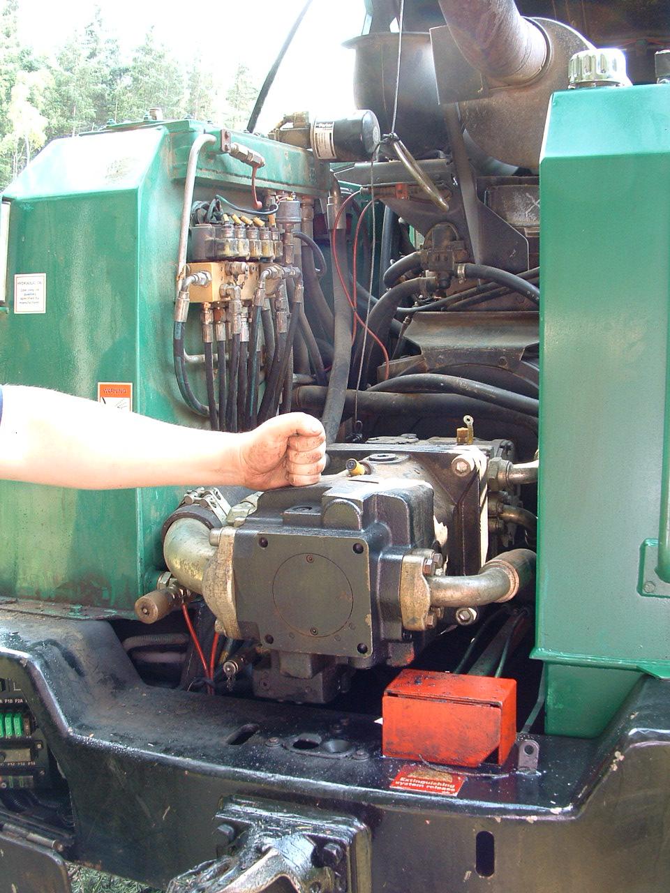

OK, lets have a look at an hydraulic machine used for felling timber.
This is its hydraulic pump, driven by a 200HP diesel engine. The pump is far smaller than the engine, hydraulics have a much higher "power density" (for want of a better word) than IC engines or electric motors.

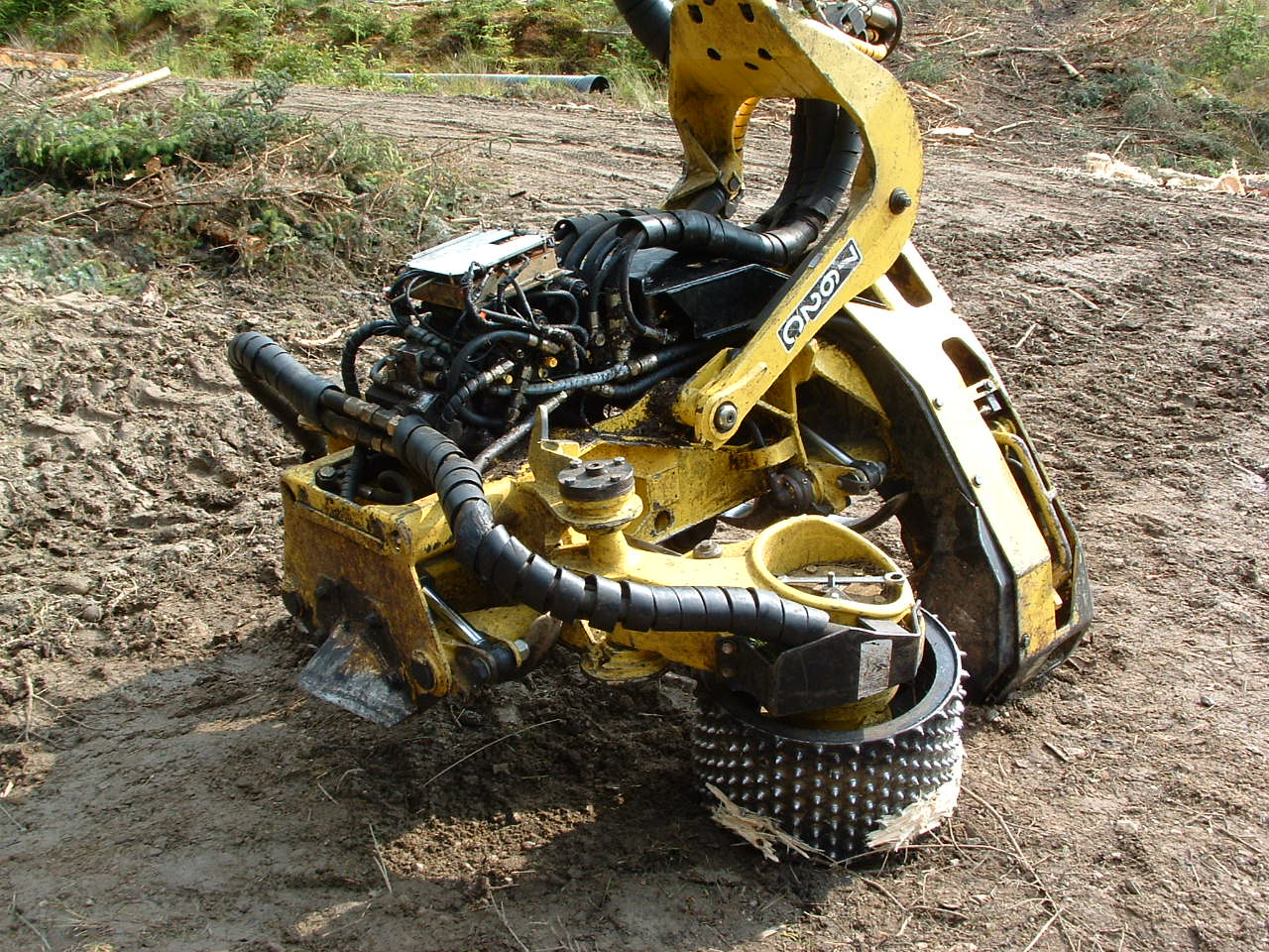

And the tool which cuts the tree, strips the branches, and cuts the tree trunk into logs of the required size.
No problem there in distributing the hydraulic power where it is required, you just need the right flexible hose.
I cannot remember what pressure this lot worked at, probably 207 Bar (3000 psi in old money!).
