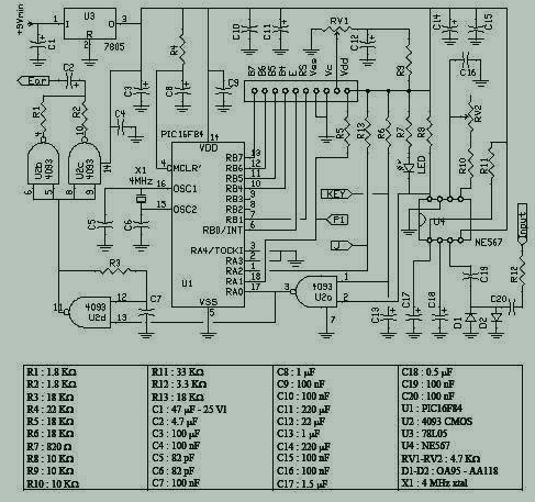

I have entered the components into Kikad, now to place them on the circuit board, thanks to IK3OIL. I was reading that some components should not be in close proximity to others. Are there any suggestions please? I tried and failed to be able to upload a schematic, but there is a PIC chip, NE567 decoder, and a 4093 NAND gate.

A schematic will be really helpful. Have you tried a print screen or snippet (Win7) in .png? How does the NE567 come into play? Are you using different tones?

The circuit detectsthe morse tones, then measures the spaces to be eble to decode it. 'MAGVITRON' re-wrote the code to help me use a different PIC chip than the one in the diagram.
