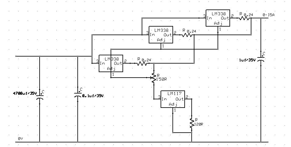

Please check my simple circuit for errors
ceefna
Hi everybody, do you think this circuir will work as variable current power source. If you spot any errors or if you just think its rubbish please let me know what mods I need to make.

Hmmm... The LM117 with 120 ohm adjust resistor is a 100mA constant current drain. It will draw 100mA throught the 150 ohm trimpot, giving an adjustment of 0v to 1.5v. You need an adjustment of 0v to 1.2v to give full range adjust of the LM338s.
Looks workable, and pretty clever. Is that circuit from a design note or is it yours?
I think you should always add a 10uF caps on the adjust pin from the top of trimpot to wiper of the trimpot to stabilise the adjustment voltage.
And don't forget some real large heatsinks...
Hi Mr RB, the circuit is from the 338 data sheet that I just added more 338's in parallel to give more current. I was the one with the anodising power supply thread but that doesn't seem to be getting anywhere so i thought i would just stick my plan on to get some feedback. Wish I knew what i was doing with electronics. I understand the very basic stuff but as for working out what the correct resistance on the LM117 should be??????
Can you help.

Whoops that's 10mA through the LM117, I said 100mA sorry.
Your resistor values don't seem too bad, the LM338 datasheet says it only needs about 50uA from the adjust pin, which typically changes less than 1uA so using 10mA for the biasing circuit seems fine.
Maybe someone else can see a problem? It's real late here and I need some sleep. :)
I have never tried it, it's possible it may work. It's been my experience in general that linear regs get unhappy when you parallel them becaue they try to "buck" against each other. maybe this will work because it's trying to be a curret source and not a voltage source (?)
Hi, think I will build it and see what happens. Like in "Field of Dreams,build it and they will come" the amps I hope!! :D
Ceefna
Since each regulator has its own current sense resistor they should act like emitter resistors and balance the current nicely. If you tried to do it with just 1 current sense resistor it could get ugly.
