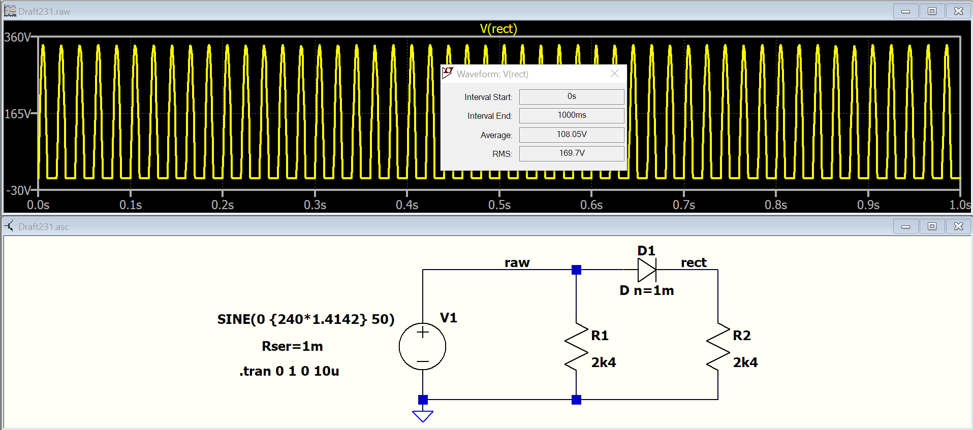

As this totally confuses me I set it up in LTspace using 240V AC (looks like LTspice uses peak voltage) and a 240R resistor. As expected the current through the resistor is a sign wave with a peak of 1A. Adding a diode just takes away half the current and leaves the peak unchanged. So, it's got to be half the power.
adding a half wave rectifier reduces the RMS VOLTAGE by half
No, it doesn't. The result is 0.707 times the original.
OK, confused again.
Don't be. The on half-cycle is unaffected. The off half-cycle reduces the long-term RMS voltage and power. The 0.707 figure (half the square root of 2) and the posted sim relate to long-term RMS voltage, not power. Long-term average power gets halved.

Perhaps you ought to try reading the posts?, which all refer to a half wave rectifier (single diode), which is this thread is used for alow power setting on small heating elements.
Obviously for a full wave rectifier the RMS voltage is the same as no rectifier (less the insignificant diode voltage drop of course).
And your 'conclusion' is similarly confused, as you're mixing VOLTAGE and POWER, which seems to be the common error through out this thread. Half the voltage means quarter of the power, it's hardly difficult - apply ohms law!.

Again, you've leapt to POWER instead of VOLTAGE - adding the diode halves the voltage. Stick a rectifier in circuit and measure the RMS voltage out, preferably with a load - I did it yesterday without a load (couldn't find anything suitable). RMS voltage with the diode shorted out was 25V, with the diode in-circuit it was 14V.
The long term average over many cycles (or indeed one) is then 50% of full VOLTAGE - can anyone argue that?.
