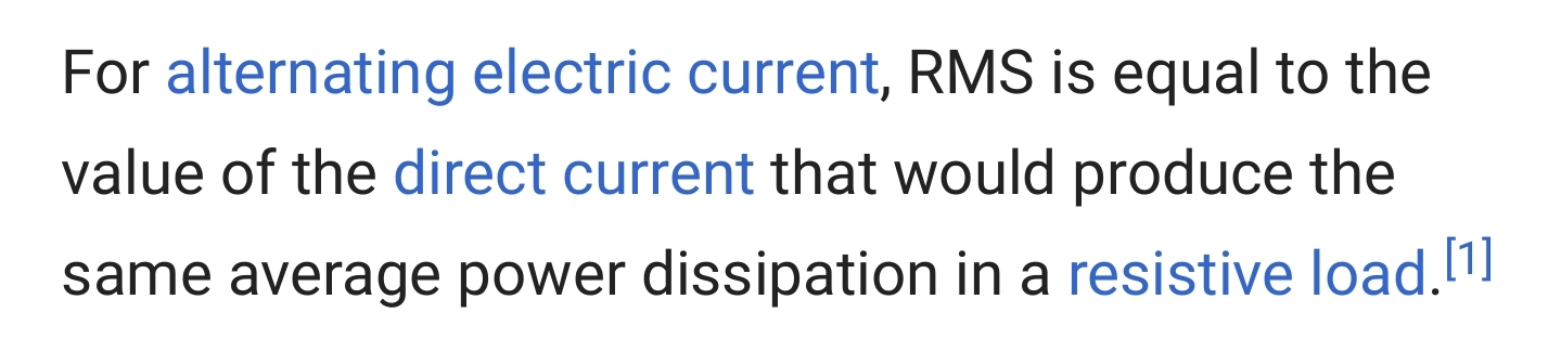

...The load fed through the rec definitely dissipates half the full cycle power....
It's kind of like RMS actually means something in the real world, right?

Your 240v value here is stated wrong! 240v "peak" times(x) 0.707 equals(=) 170v RMS. 240v RMS half wave rectified, would be 240v RMS? NO? "Peak to Peak " in this case now would be 480v. Hi, Hi.Don't you believe the post #45 sim Nigel?
That has a 240V RMS input and the half-wave rectified output is ~170V RMS, not 120V RMS as you think.
